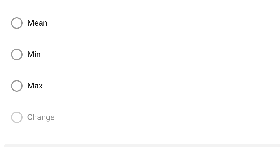

Show, as in the dashboard? You can select this in the statistics card.
To be clear, I’d like to have those values as entities, if possible. Show wasn’t really what I meant.
