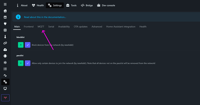

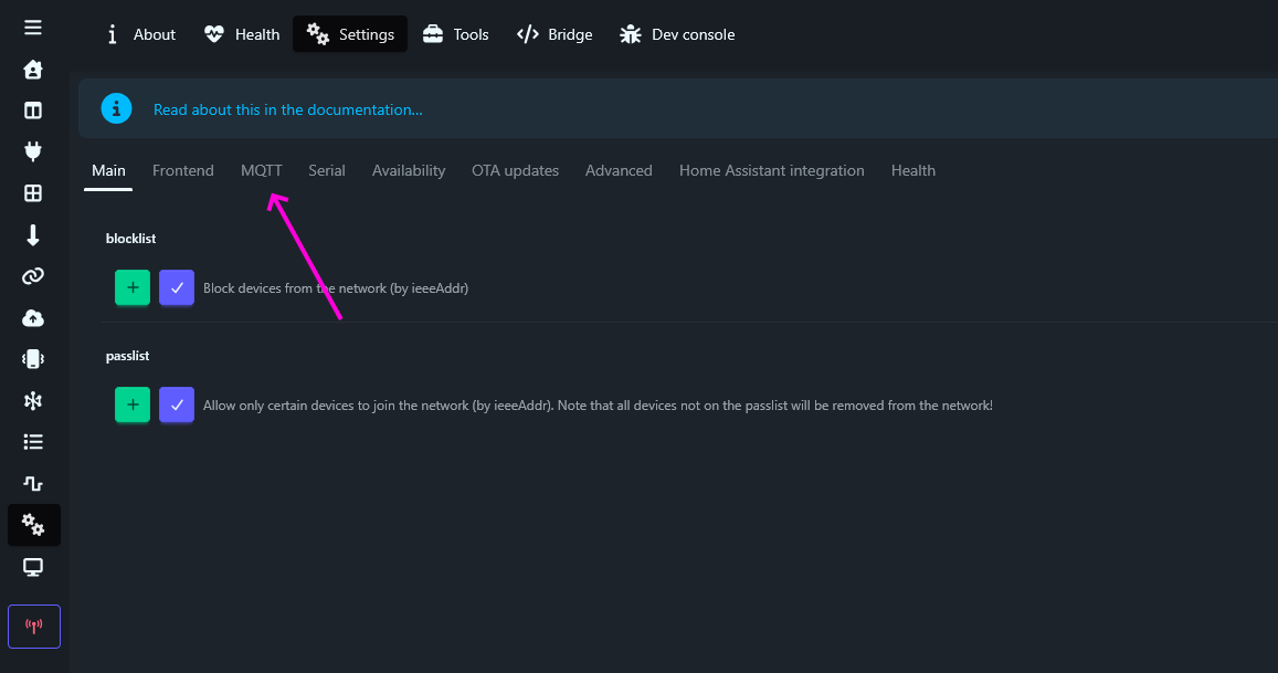

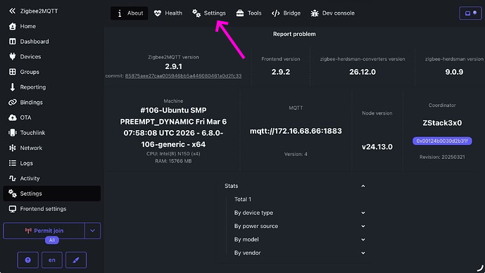

On that page click settings:
Then MQTT:
The important server settings are towards the bottom of that page. Server, user and password.

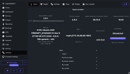

I set those. There doesn’t appear to be a “save” button but when moving the focus off password the log shows
[3/25/2026, 12:06:18 AM] z2m:mqtt: MQTT publish: topic 'zigbee2mqtt/bridge/response/options', payload '{"data":{"restart_required":true},"status":"ok","transaction":"thpwk-7"}'
[3/25/2026, 12:06:19 AM] frontend:api:bridge: Sending {"topic":"bridge/request/options","payload":{"options":{"mqtt":{"reject_unauthorized":false}},"transaction":"thpwk-8"}}
[3/25/2026, 12:06:19 AM] z2m: Successfully changed options
[3/25/2026, 12:06:19 AM] z2m:mqtt: MQTT publish: topic 'zigbee2mqtt/bridge/response/options', payload '{"data":{"restart_required":true},"status":"ok","transaction":"thpwk-8"}'

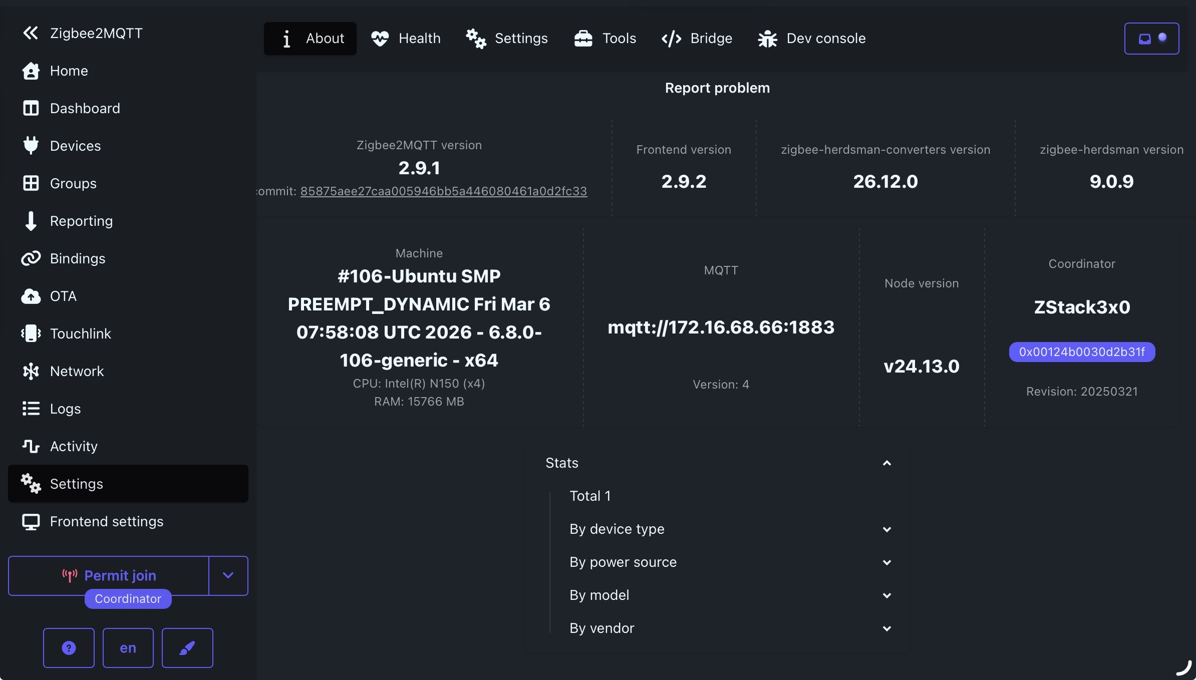

So it appears it saved, howver after restarting the password field is empty. Not obfuscated, but blank. But something appears to have happened. I now see a coordinator

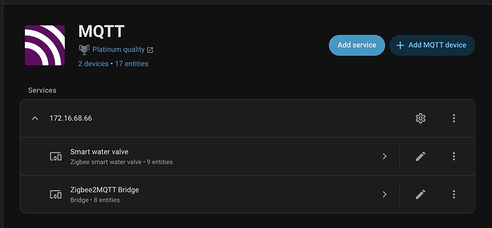

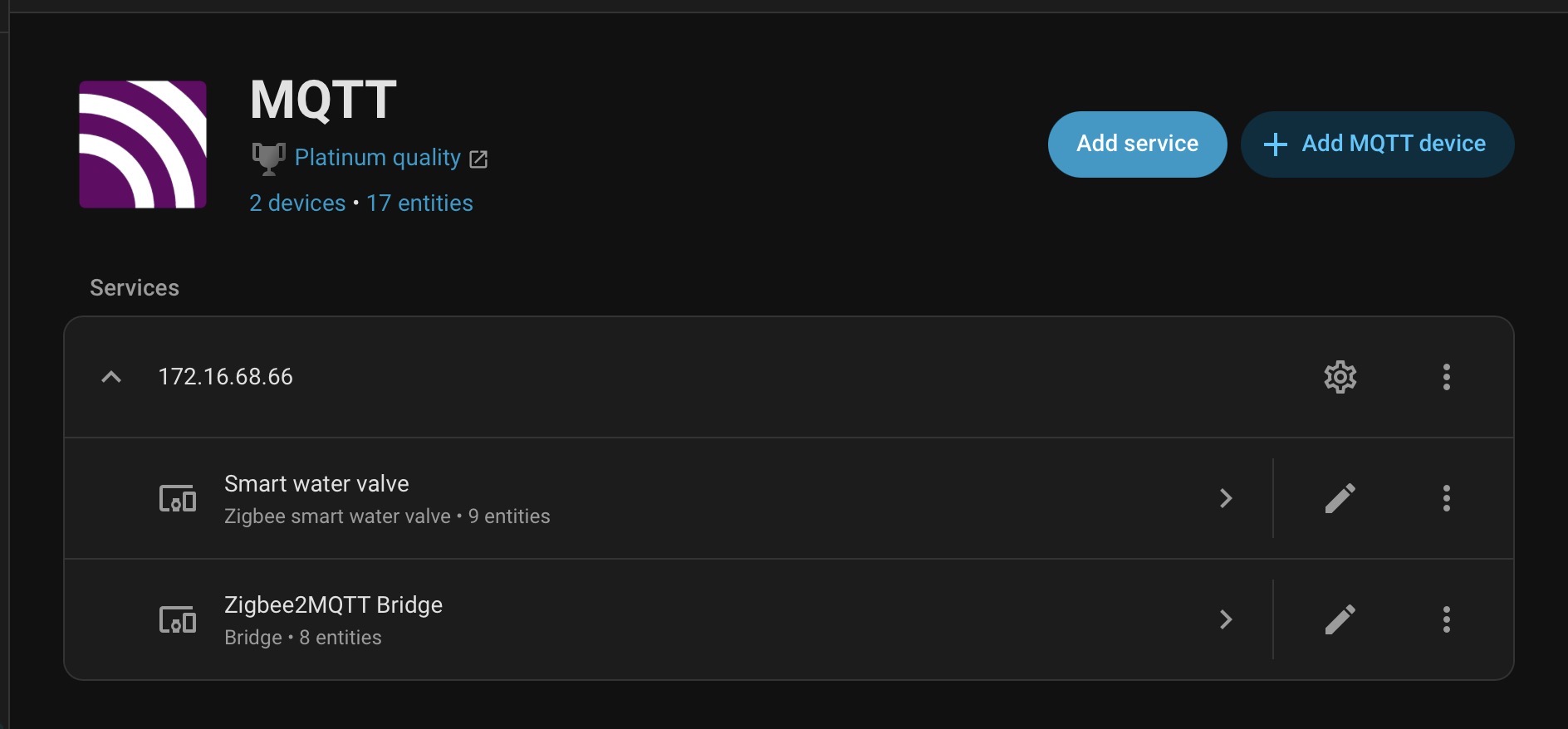

But neither the “bridge” nor the smart-valve appear anyplace in HA like they did in the MQTT integration the way they did on the old host. From somewhere in the WindFront GUI i can toggle the valve on/off. But it’s not showing anyplace in HA. I even tried re-adding the valve with “permit join” and nada.

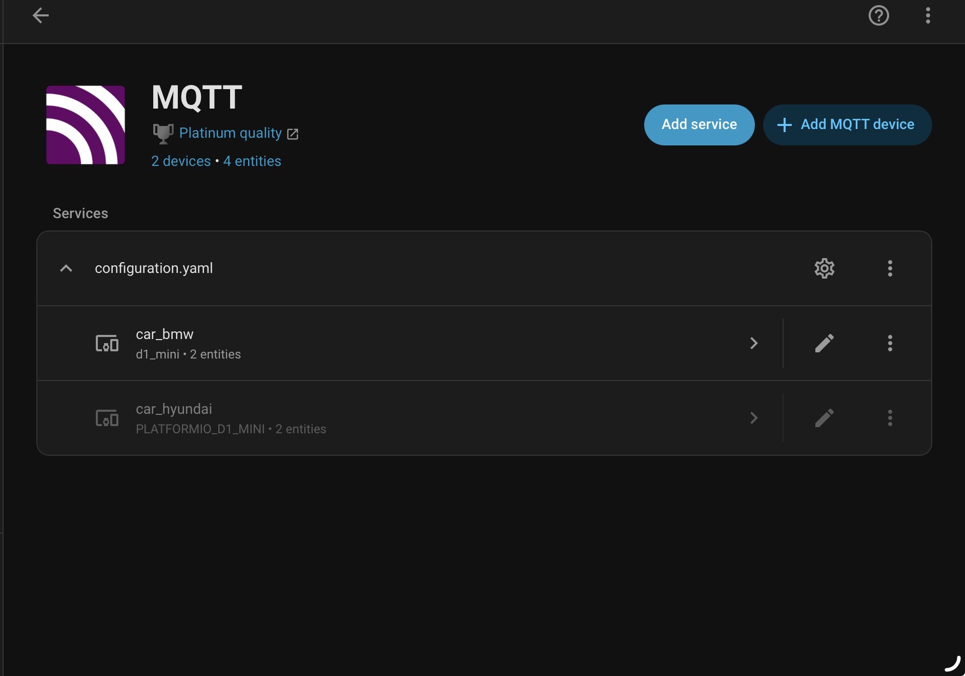

Im not sure what to look for in the logs, but I think I have the integration installed. In fact there are a couple of ESPHome nodes showing. It’s on this screen where the old host showed the “bridge” and smartvalve. IIRC the bridge allowed me to do a “permit join” and add new zigbee devices as an alternative to the WindFront GUI. I’m reading somwthyabout “MQTT Discovery”. Is that another container that needs to be running?
I deleted the integration and then added it again. BOOM, they appeared!
Though my ESPHome nodes disappeared. Probably need to re-add them. In any case this appears to have gotten me over the hump. It’s probably a bug in the backup/restore functionality.
