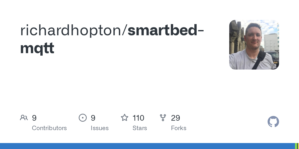

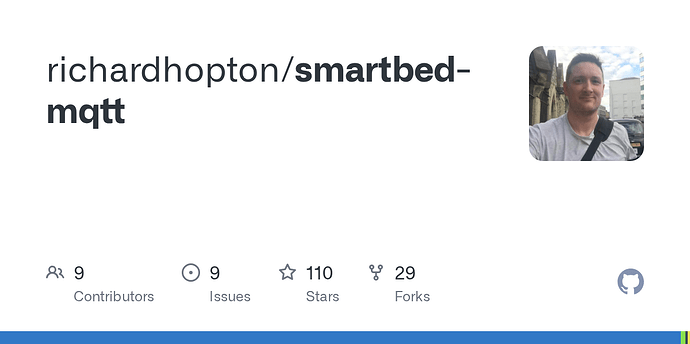

Maybe have a look at
Your brand is not mentionned, but could use the same protocol as one of the supported ones…
Did you ever manage to check out that addon and see if it works?
