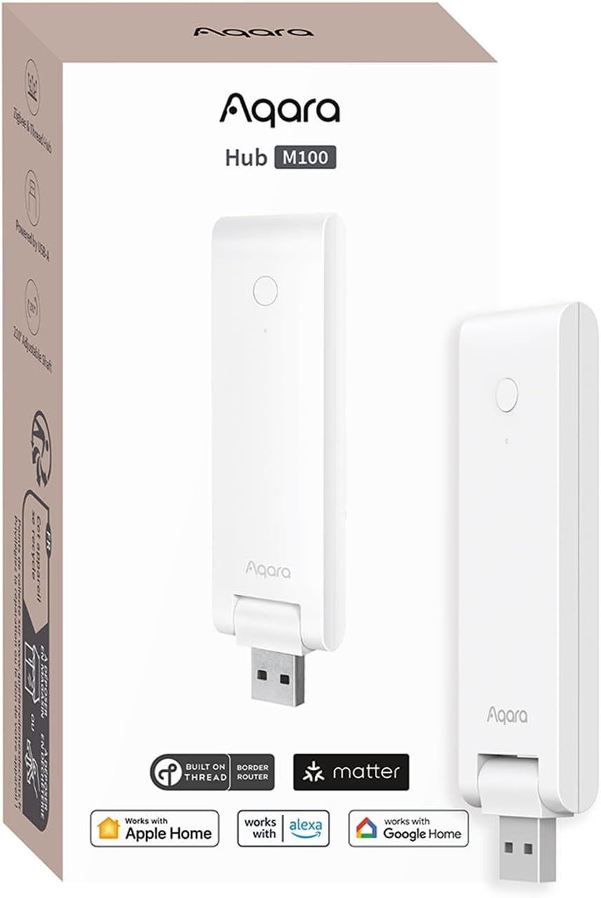

Do these also work ?, looks like a cheaper option.
This Aqara hub worked for me. I connected it to HA as a Matter device.
I now just now managed to get a Matter plug from another supplier connected to HA as well.
And I tried to get it working on Alexa. I could get the Matter plug working on Aqara and the Alexa app (using pairing codes I obtained via sharing on home assistant).
Will retry with another Matter plug and also on Google Home to see if I can get it working… So far I connected Google Home to HA Nabu Casa.
