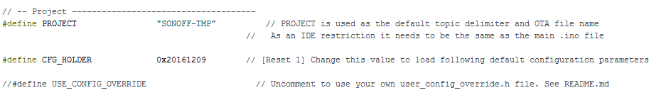

When you first Put Tasmota on to Sonoff Its hard to find the IPaddress of it Well log into router and get that way
Before you flash it change the Project Name to SONOFF-TMP as this is the default Topic
And setup the MQTT stuff save it
now you can flash it.
