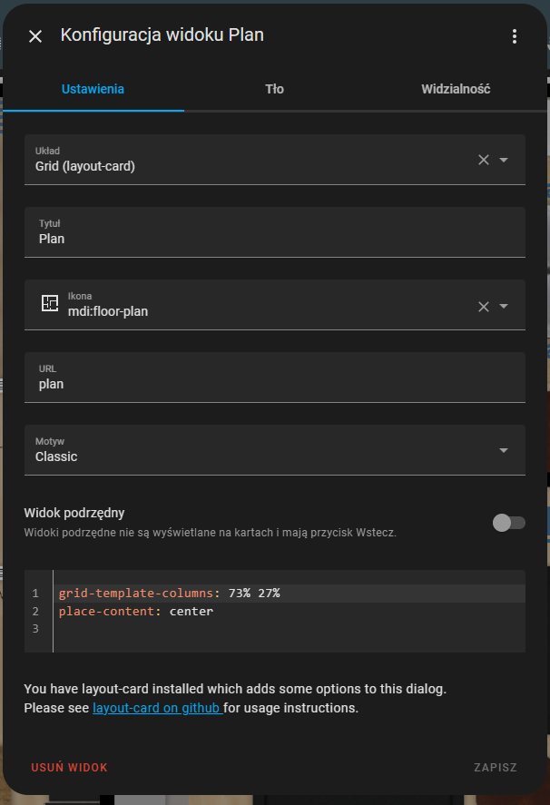

Use layout card while adding new view from HACS and then specify what size each element should be:
grid-template-columns: 73% 27%
place-content: center

That looks exactly like what i am after. I assume I will need HACS to do this. In an attempt to keep things simple I have been avoiding installing it. Thank you
