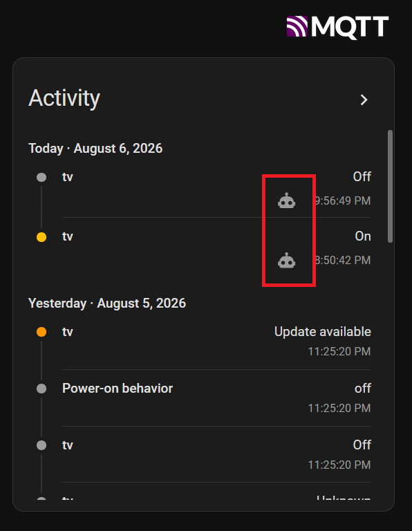

Hi, have you checked the device activity history?
It shows what controlled it.
That was the frustrating aspect. . . the activity history wouldn’t reveal anything about the random activities, only ones an automation or physical action initiated.
