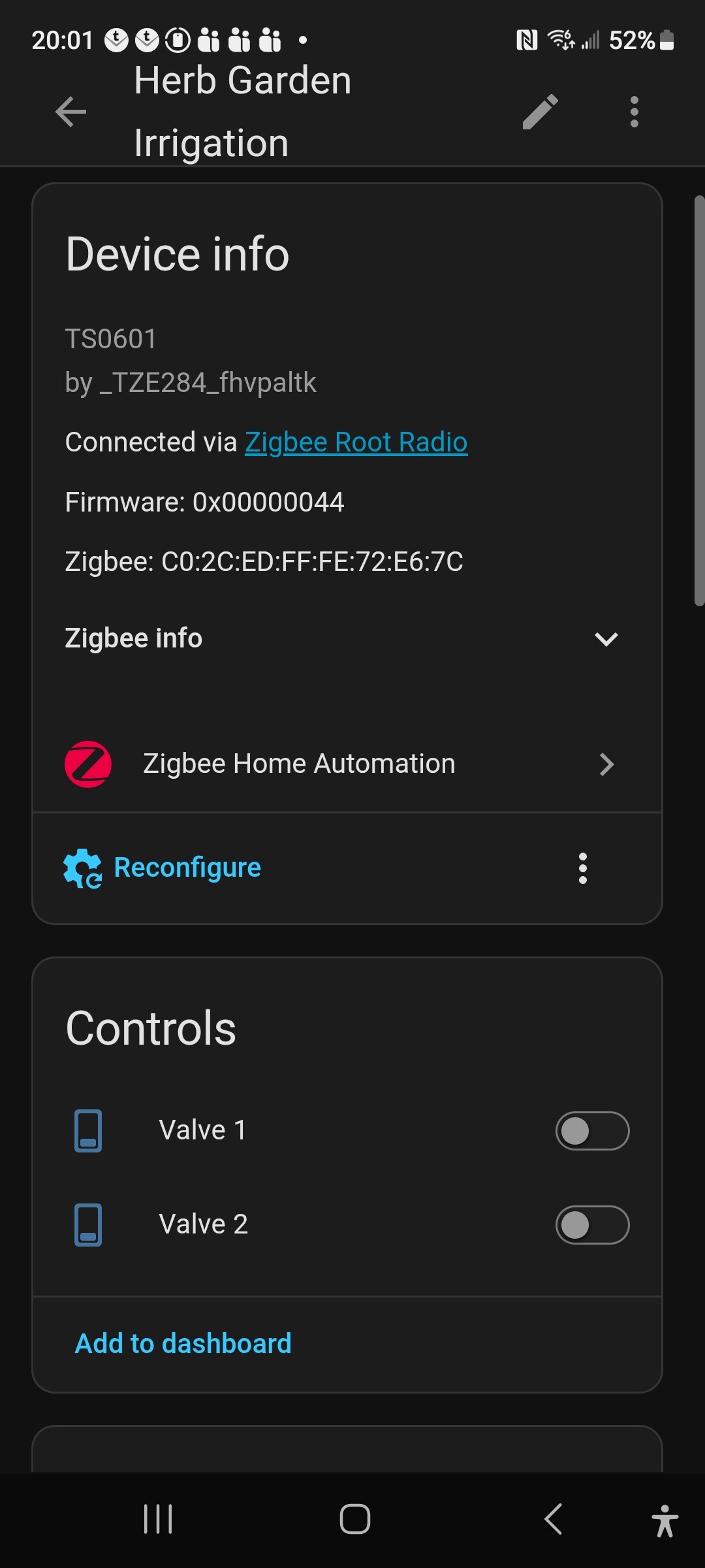

@Giex: I just received this SGW08 and it was added to ZHA without any problems.
However switching the valves from HA does not work. If I turn the valves on/off manually using the buttons on the device it works just fine and their status gets reflected on HA with the status sensor showing "Manual" when "ON" then eventually "idle" when "OFF". But turning the valves on/off via HA does not actually turn the valves on/off. There is no error reported that the device did not respond and the valve "switch" stays "ON" until I turn it off.
I'm on 2026.7.0

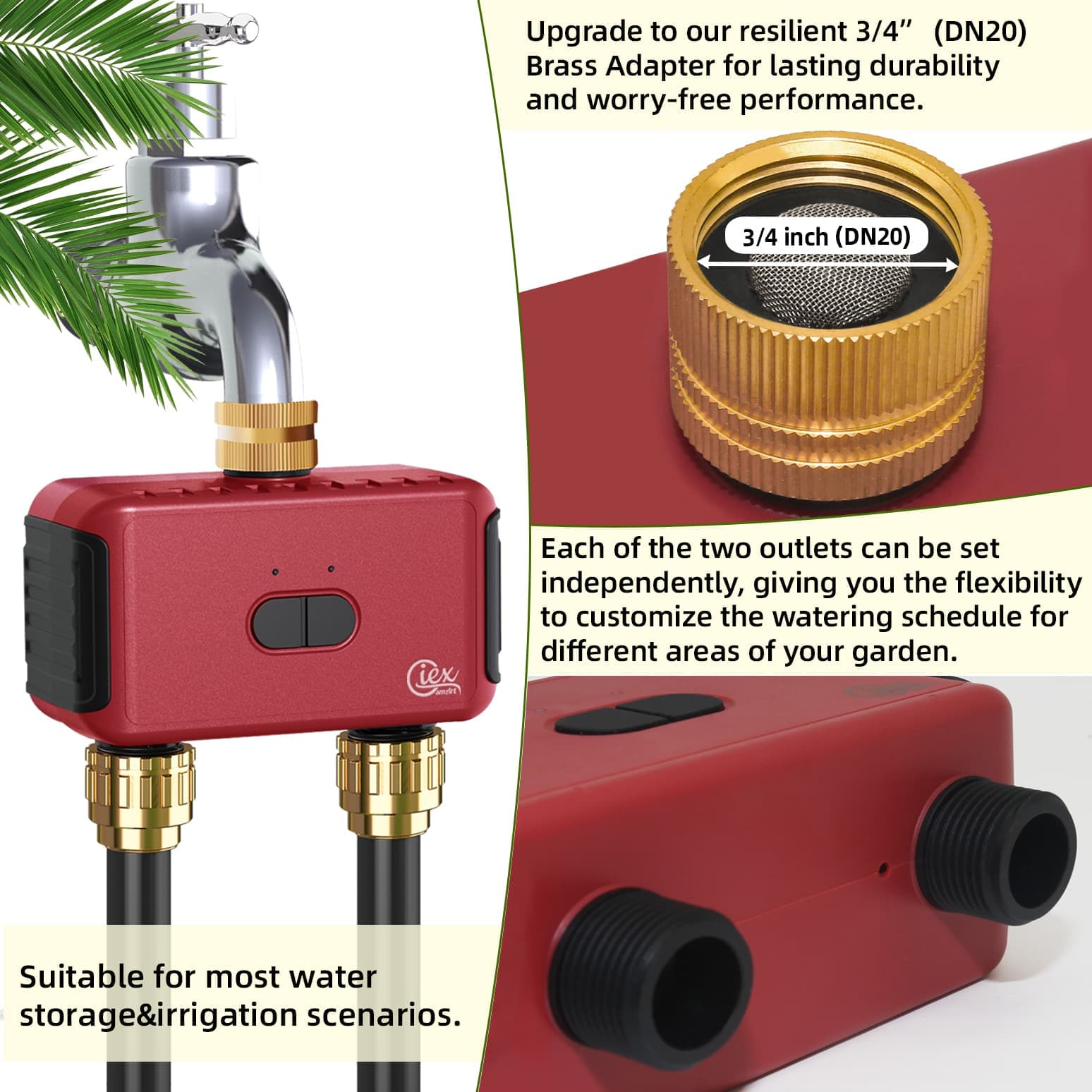

On an unrelated note: getting the connectors not to leak was a PITA! I just re-read the listing and it is G thead, not NPT!
Hi there! Thanks for sharing the picture and the details of your issue.
Looking at the device fingerprint you mentioned, it seems it doesn’t quite match our product’s signature. It’s possible that the pairing process wasn’t fully completed, which can result in an incorrect fingerprint being recognized by ZHA. Could you try moving the device much closer to your gateway and pairing it again just to rule out any signal range issues?
Regarding the thread type, you mentioned needing an NPT thread, but the device you received has a G thread. Based on this, I’m assuming you might be located in the US, Canada, Mexico, or Colombia. For these regions, our default shipments use GHT (Garden Hose Thread), which is the standard for outdoor faucets there.
If you did receive a G thread device by mistake, please shoot us an email at [email protected] so our after-sales team can help you get a replacement with the correct thread.
Just a quick note to clarify: NPT and GHT threads are actually different. In the US, NPT is typically used for indoor plumbing, while GHT is used for outdoor setups (like garden faucets, hoses, washing machines, RVs, etc.). They aren’t compatible, so connecting to an NPT faucet will indeed cause leaks, but this wouldn’t be because the wrong item was sent. Please double-check if your faucet actually requires a GHT (or NH) thread instead. We don’t manufacture this timer with NPT threads since they aren’t commonly used for outdoor watering.
Let me know if moving it closer to the gateway helps, or if you have any other questions!
Thank you for your reply. Will try pairing closer to the radio and update (it’ll be in a couple of weeks).
The G vs GHT thread is my mistake: the AliExpress listing clearly states it is G thread.
Because AliExpress serves customers from all over the world, the product page usually shows only one thread standard. However, we normally select and ship the appropriate thread type according to the destination country.
If you are in a country that uses the US GHT thread standard but have received a product with a G/BSP thread, we will take responsibility and help resolve the issue.
If you have any questions, please contact us at [email protected] for support. It is a pleasure to meet such an understanding customer. If you encounter any other issues while using the product, please feel free to contact us at any time.

@Giex
Pairing closer to the radio fixed the issue! Thank you!
