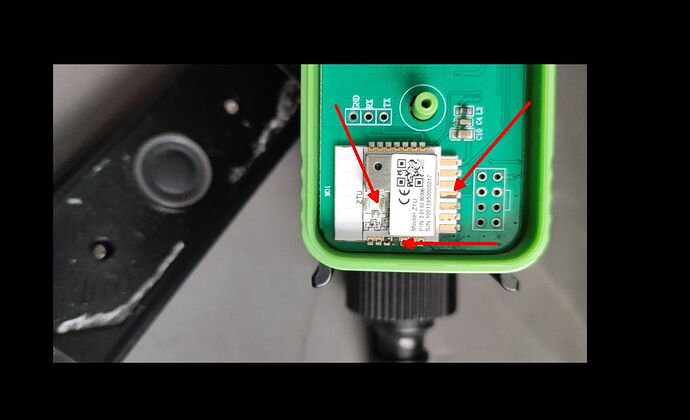

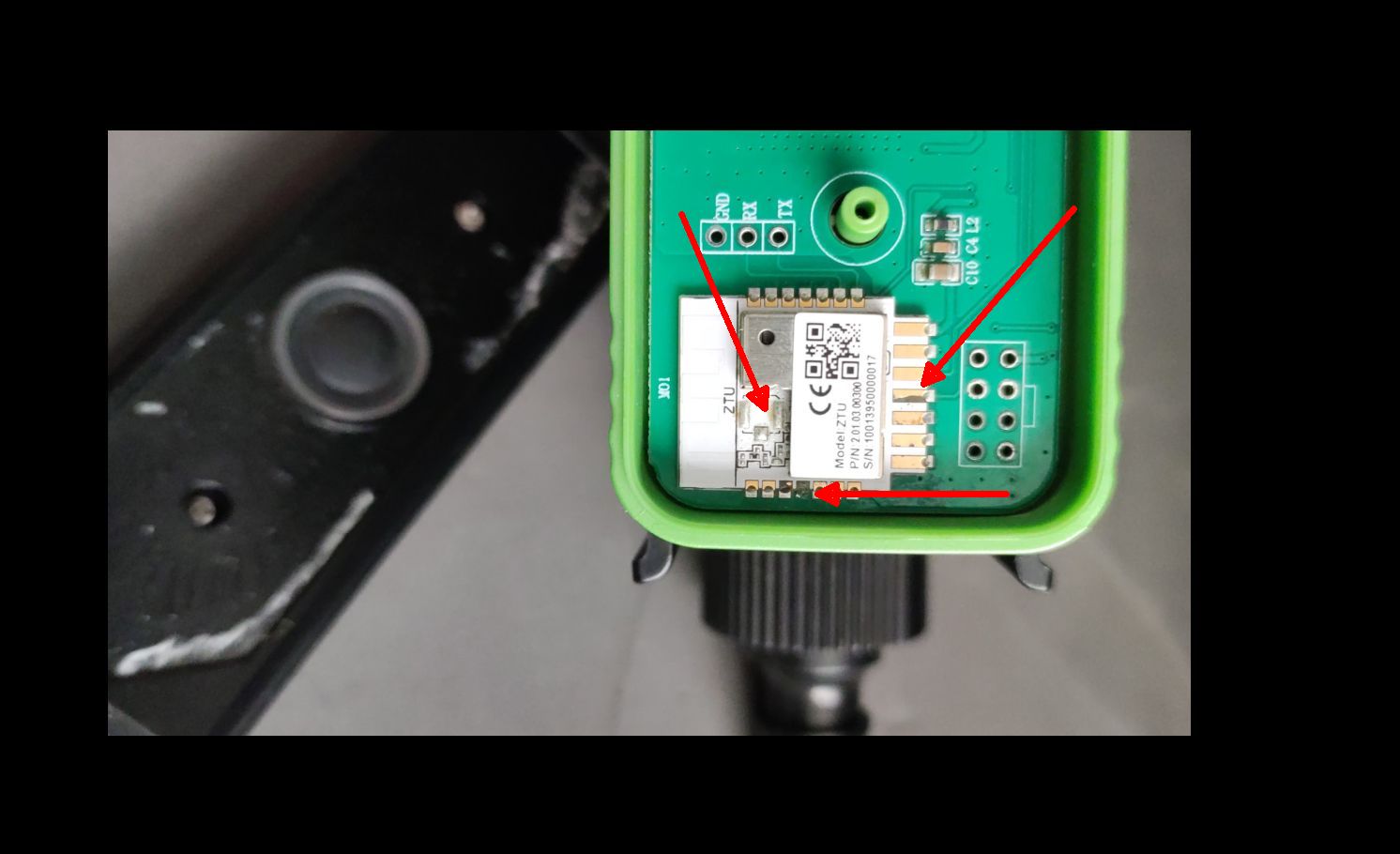

I’ve already found the problem: although the valve is IP55, water has entered and affected the ZigBee module. This module is also positioned on the lower edge of the housing, where water can accumulate (GIEX: another design error).
I’ve cleaned off as much of the rust as I could, but it’s still causing range issues (<1 m). The photo shows the visible affected parts. I’ll try to unsolder it and clean it better.
For those of you who have it installed in exposed locations or who notice a leak in the upper thread… good luck.
Sorry for the English translated by Google.
Is the leak happening from inside the device or from rain and water outside ?
The moisture comes from rainwater that seeps inside. The front cover of the device does not have a sealing gasket. The battery pack does have a gasket, and you might assume everything is properly sealed, but that is not the case.
I would recommend that anyone with the device exposed to the elements apply silicone grease to the front cover’s groove. I haven’t disassembled the back cover, but as a precaution, I would do the same there as well.
