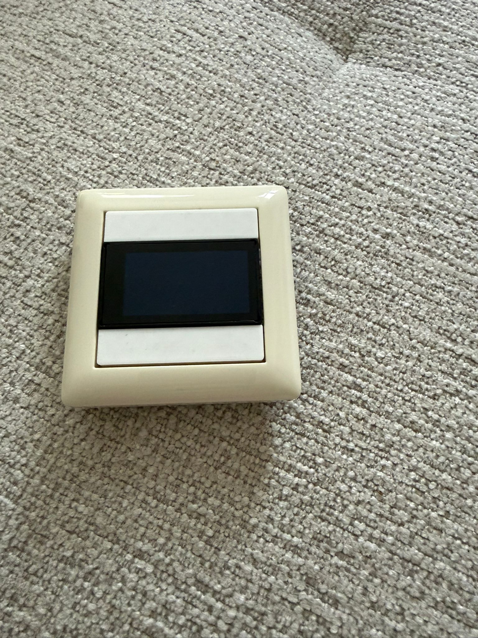

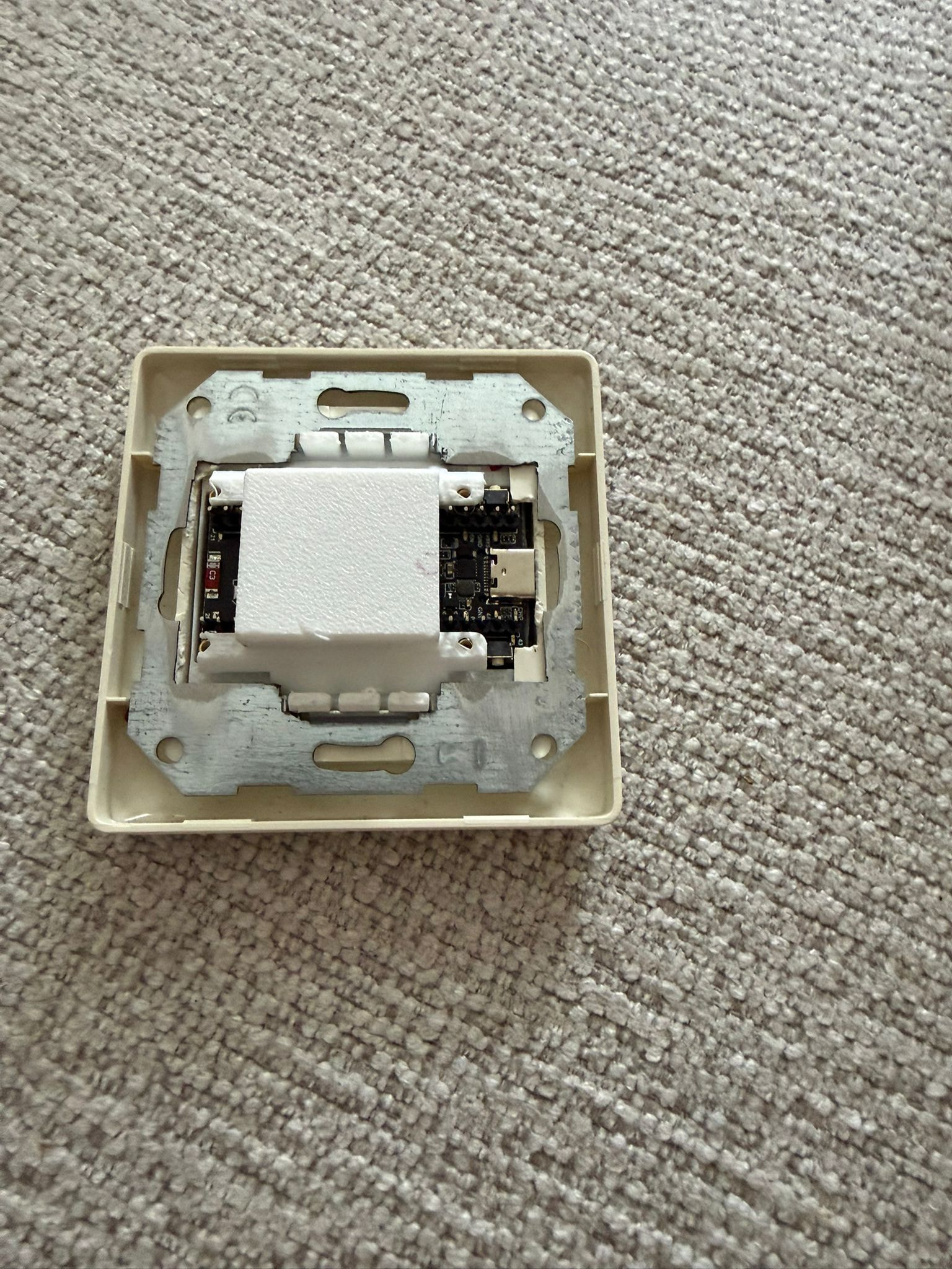

I like to show a 3d printed moanting frame for Gira system 55 wall plates.
later on i will write some kind of manual on github how i mannaged to fit the ESP32S3 touch LCD 1.9inch into a blind plate from Gira system 55.
I'm in the process of make a couple of these for in my new house, please don't mind the color different in the printed part and the mounting frame from gira, didn't have a white one lying around.

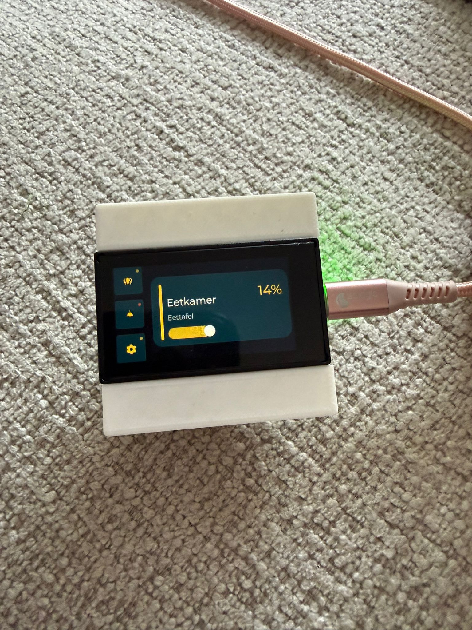

there is on github also a simple example file, i'm not that good with LVGL, so if someone could write a better example with a more advanced theme/gui.
This one is partly developed with the help of ESPhome LVGL Editor
