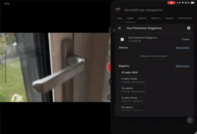

Each AUX input from the BTicino bus can now be configured dynamically via a single JSON line at startup.
Here is how an IR sensor in the garage is defined:
JSON
{"type":"Aux", "name": "IR Garage", "address": "6", "debounce": 20000, "room": "Garage"}
