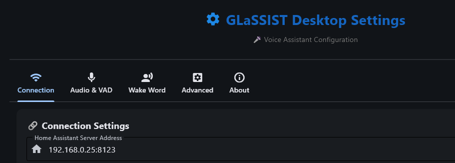

Your work seems amazing. I am trying to make it work but the connection to my local Home Assistant fails with in the logs
2025-08-30 13:39:36,360 - haassist - INFO - Connecting to Home Assistant: wss://homeassistant.local:8123/api/websocket
2025-08-30 13:39:36,480 - haassist - ERROR - Connection error: [SSL: WRONG_VERSION_NUMBER] wrong version number (_ssl.c:1028)
I am new to Home Assistant so maybe I am doing something wrong
I am running HA in a VirtualBox on the same computer as GLaSSIST (Windows 10)
Can you try change server address to your VM IP, not dns?
For example:
192.168.0.5:8123?
Over here:
Also try to update your homeassistant instance to newest version if possible. If it will not work i will add some more code to debug this problem deeper for you.
Update:
If i set my GLaSSIST to homeassistant.local:8123 it’s also not working, so setting IP address should resolve the problem 99% :wink:
2025-08-31 22:36:15,283 - haassist - INFO - Connecting to Home Assistant: wss://homeassistant.local:8123/api/websocket
2025-08-31 22:36:18,026 - haassist - ERROR - Connection error: [SSL: WRONG_VERSION_NUMBER] wrong version number (_ssl.c:1028)
2025-08-31 22:36:18,026 - haassist - ERROR - Connection test: Cannot establish connection
