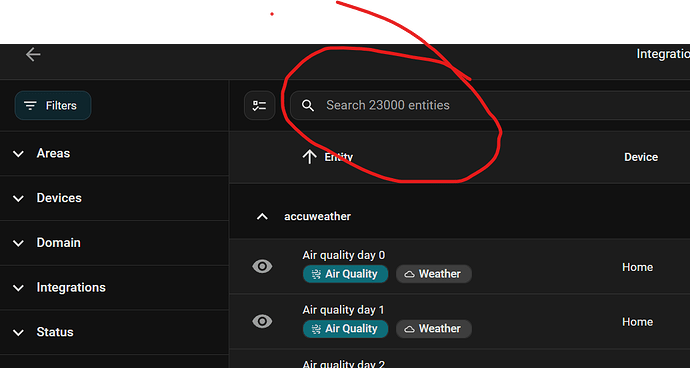

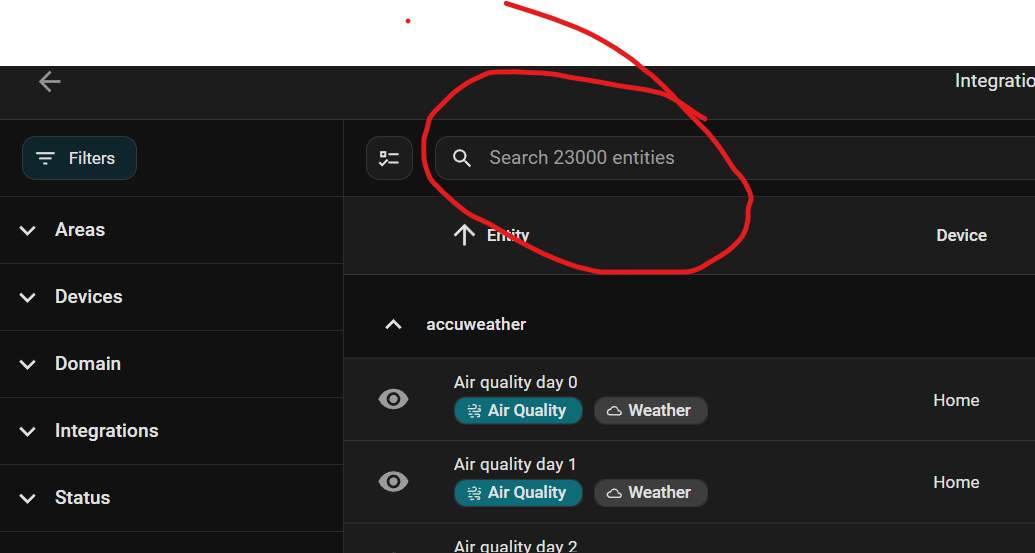

create a platform with “home assistant” to manage a minimum of 3000 luminaries of the city
if you can connect to it… Which it looks like you should be able to according to above… then HomeAssistant wont be your limitation…
