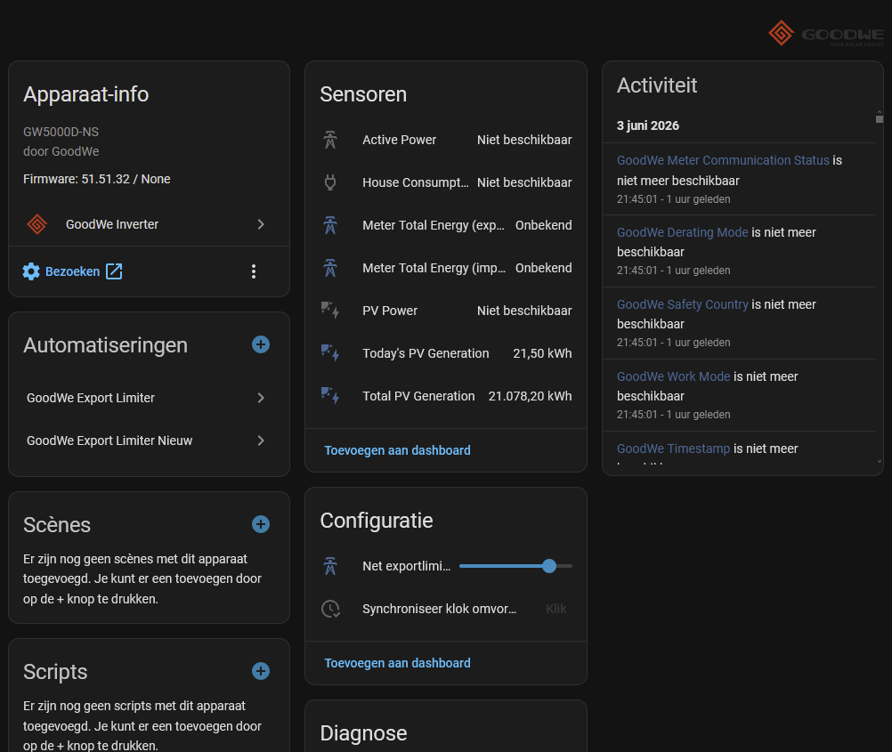

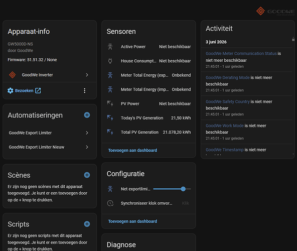

Hello M.Villing, I am new to the field of HA but would like to use your Bleuprint “Goodwe export limit with P1 HomeWizard”. I have two Goodwe inverters (GW3000N-XS) and a HomeWizard in the P1 port. I can import the data into HA but do not see any regulation regarding the export limit, and after much trying, I am at a loss for now and think I will ask the creator of the Bleuprint for help. Can and will you provide me with assistance? Regards, Arjan
Looks like the export limit entity of the Goodwe integration was removed(?) in the latest version of Home Assistant. It's listed as removed in my Home Assistant (5000 W 3-phase inverter)
I've been using it to dynamically turn off the inverter
Reloading the integration fixed it. Seems like a little networking hiccup, compounded by a PEBKAC error to these forums
Hi @oZZies
I have the same setup (GW5000D-NS and a Home Wizard P1 meter)
Can you give me a kickstart on how to fill in the blueprint with the entities of Goodwe and Home Wizard?

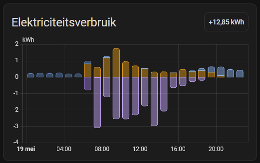

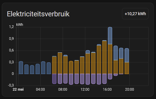

Here the results on a sunny day:
afbeelding

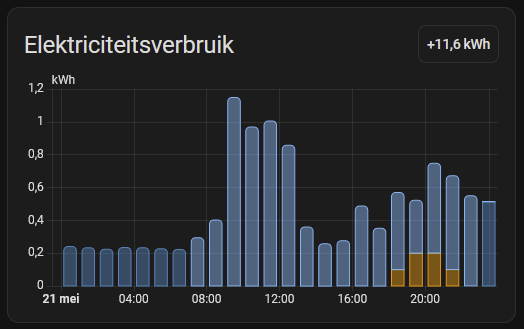

Below the result without the automation that limits the export on a partially sunny day (you can see the dips):
afbeelding

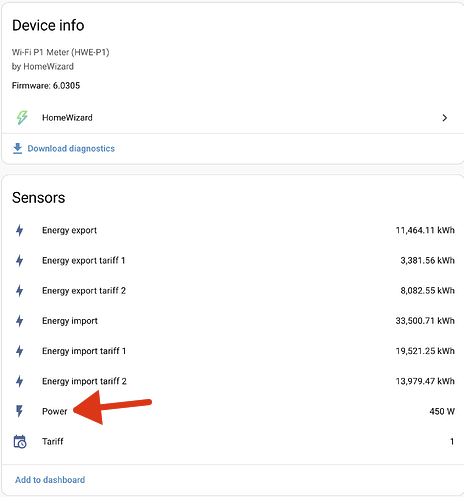

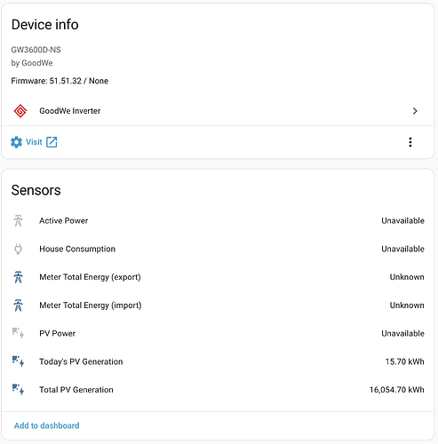

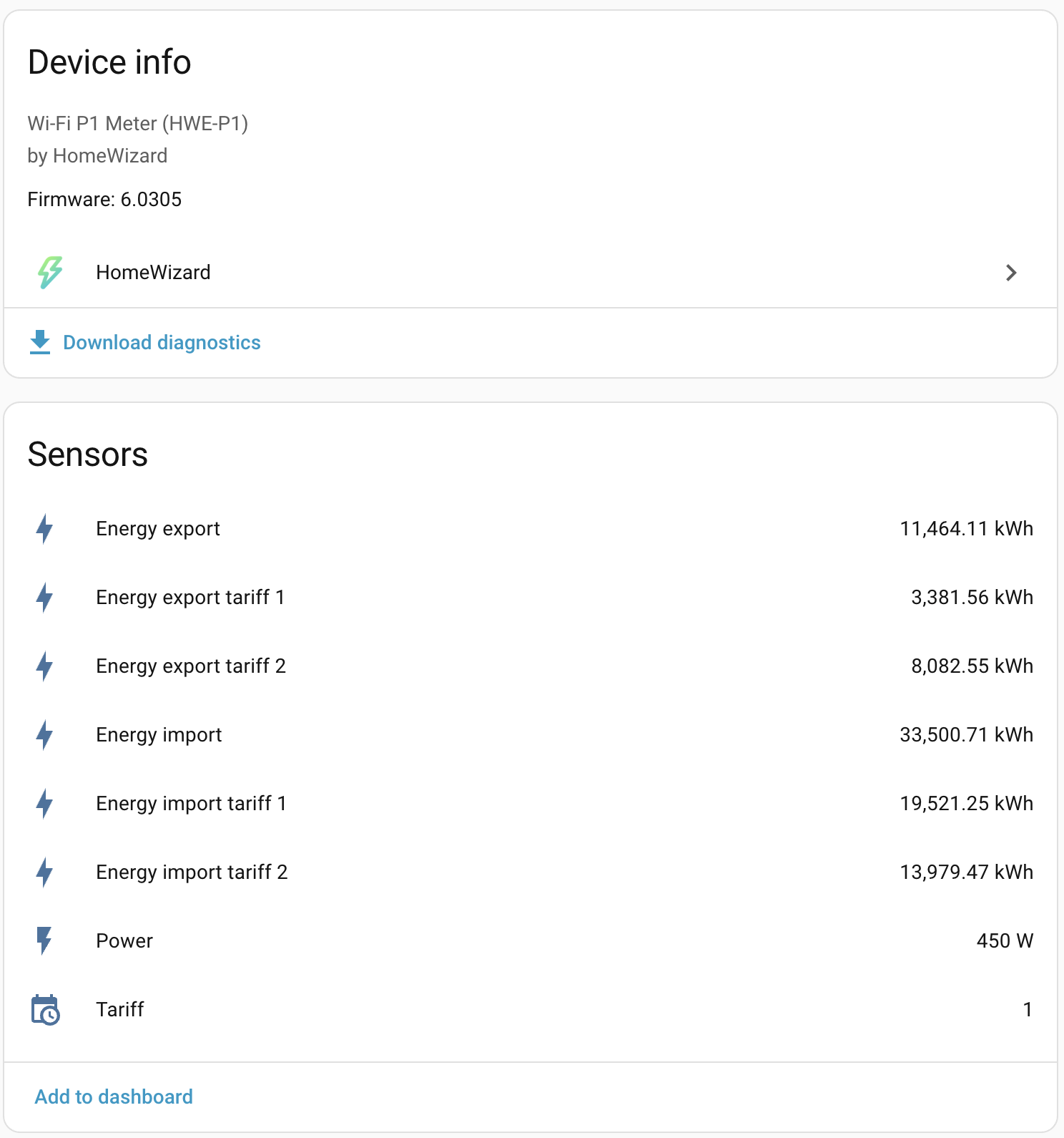

I also have a Homewizard P1 meter and a Goodwe inverter (3600D-NS). Can you confirm the following:
  • In your automation I see sensor.p1_meter_active_power. I think in my P1 meter that's called sensor.p1_meter_power (see screenshot below). Because I also see that Goodwe has a sensor called goodwe_meter_active_power, but that's not the one I should use, right?
Note: solar panels are off right now because it's night time, so that's why some sensors are unavailable.
Hi Ton,
Yes, it is the P1 sensor

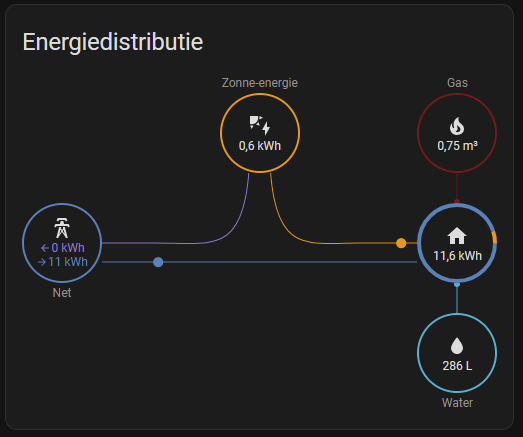

Hmm... I tested this and checked my energy results after setting the export limit to 0.
To me, an export limit of 0 means no PV power export at all .
Default, the export limit value in HA is 0 but after changing it, 0 was not an option anymore...

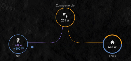

I use the custom card below, which is always accurate in real time.
type: custom:power-flow-card
entities:
  grid: sensor.p1_meter_active_power
  solar: sensor.pv_power
watt_threshold: 1000
kw_decimals: 1
uix:
  style: |
    ha-card {
      background: none;
      box-shadow: none;
      border: none;
These are the results for the day when the export limit was set to 0 :frowning:. Not funny. I noticed the issue at around 18:00, as you can see, and then changed the export limit back to 8000 so I could still generate the last bit of solar energy for the day.
I tried it too and support seems to be wrong in their statement. Export limit 0 means not generating any power at all.
Thanks for sharing your implementation. I have it running now and seems to do the job pretty well!
I disabled the export limit automation for a few days. In that time window I restarted and updated Home Assistant. After checking the export limit of my Goodwe integration after the restarts and update, it was on "0" and my converter was working normally.
Don't know what is going on with the Goodwe export limit regulator of the integration but it looks like;
  1. If you don't change the value (automation turned off) after a restart, the default = 0
  2. If you change the value (automation on), then you can't set it back to 0 because it will turn off the inverter which causing generating no PV power at all
