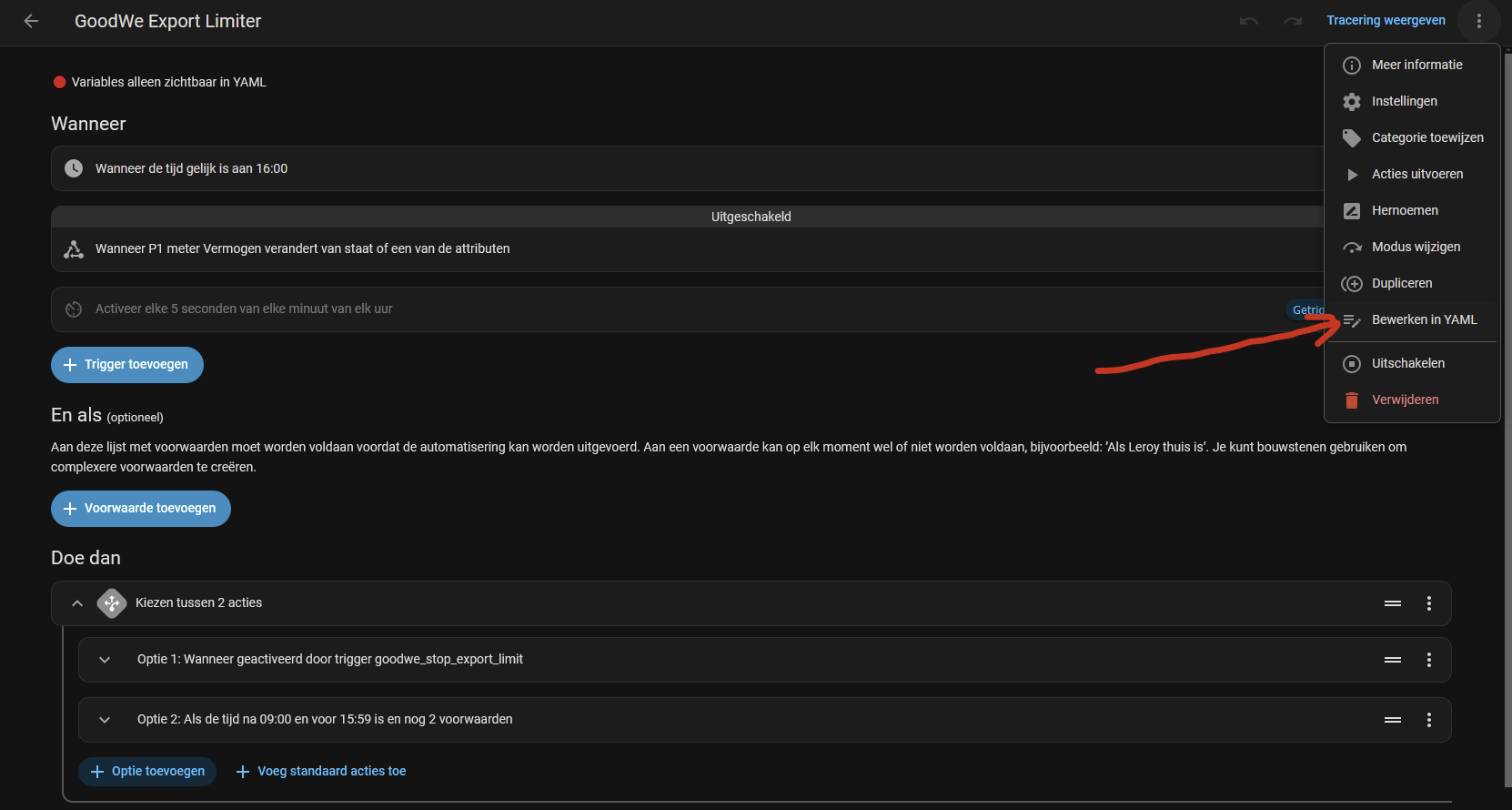

Can you share your automation .yaml?
Navigate to your automation, click on the 3 vertical dots in the upper right corner and click on "Bewerken in YAML".
Copy the code of your automation on this forum with the formatting code option!

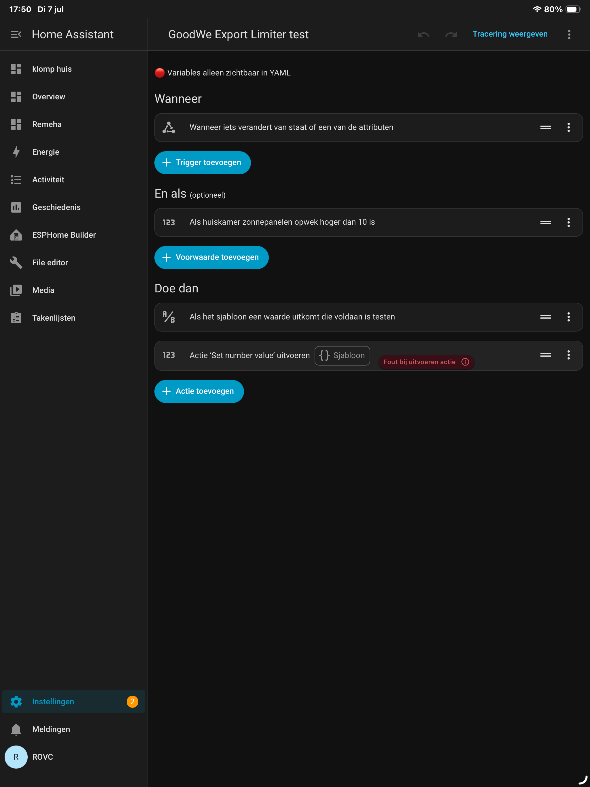

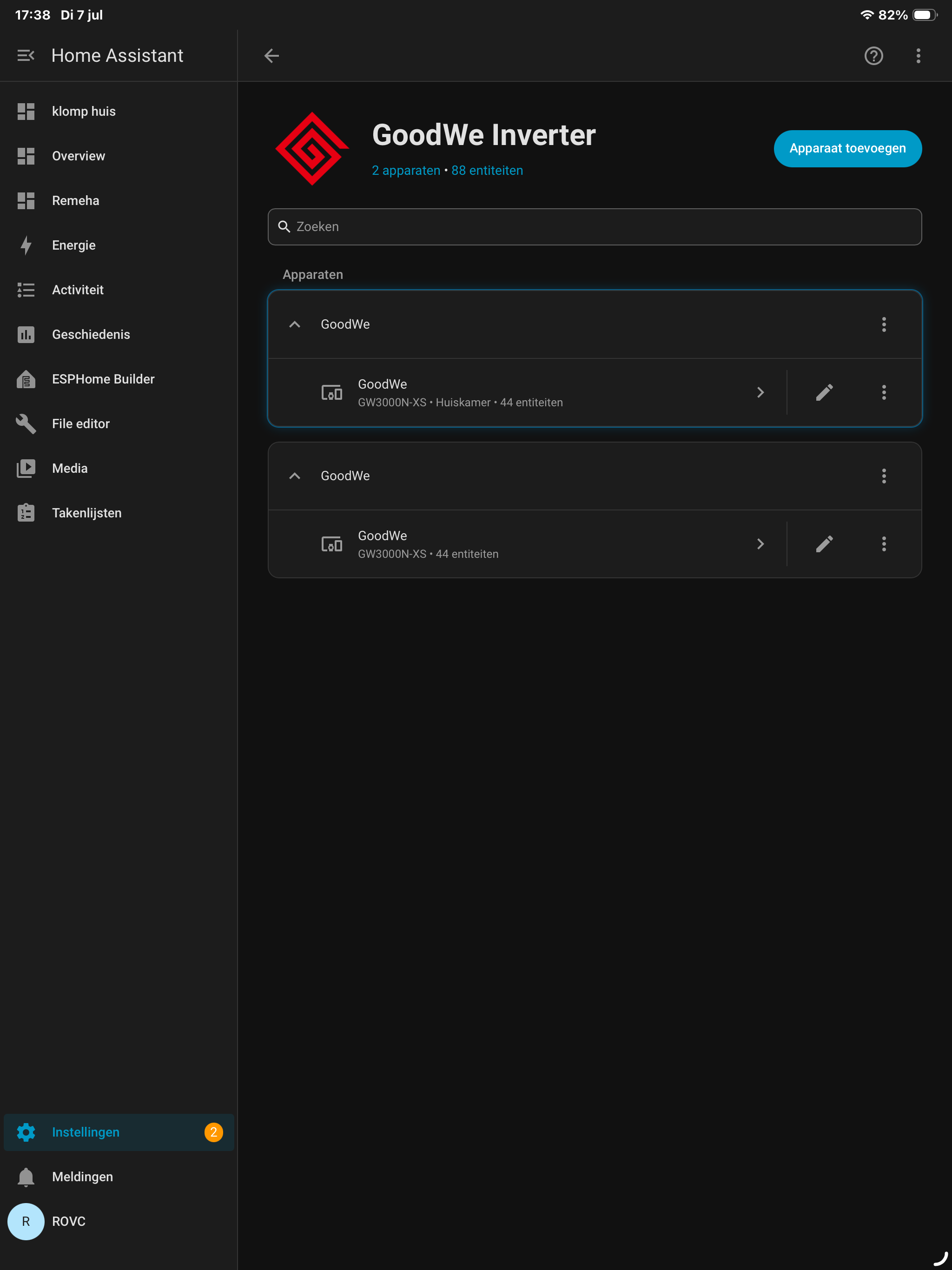

You have to be sure :wink: Which hardware are you using? (type of P1 dongle, Goodwe intverter model)
alias: GoodWe Export Limiter test
description: 🔴 Variables alleen zichtbaar in YAML

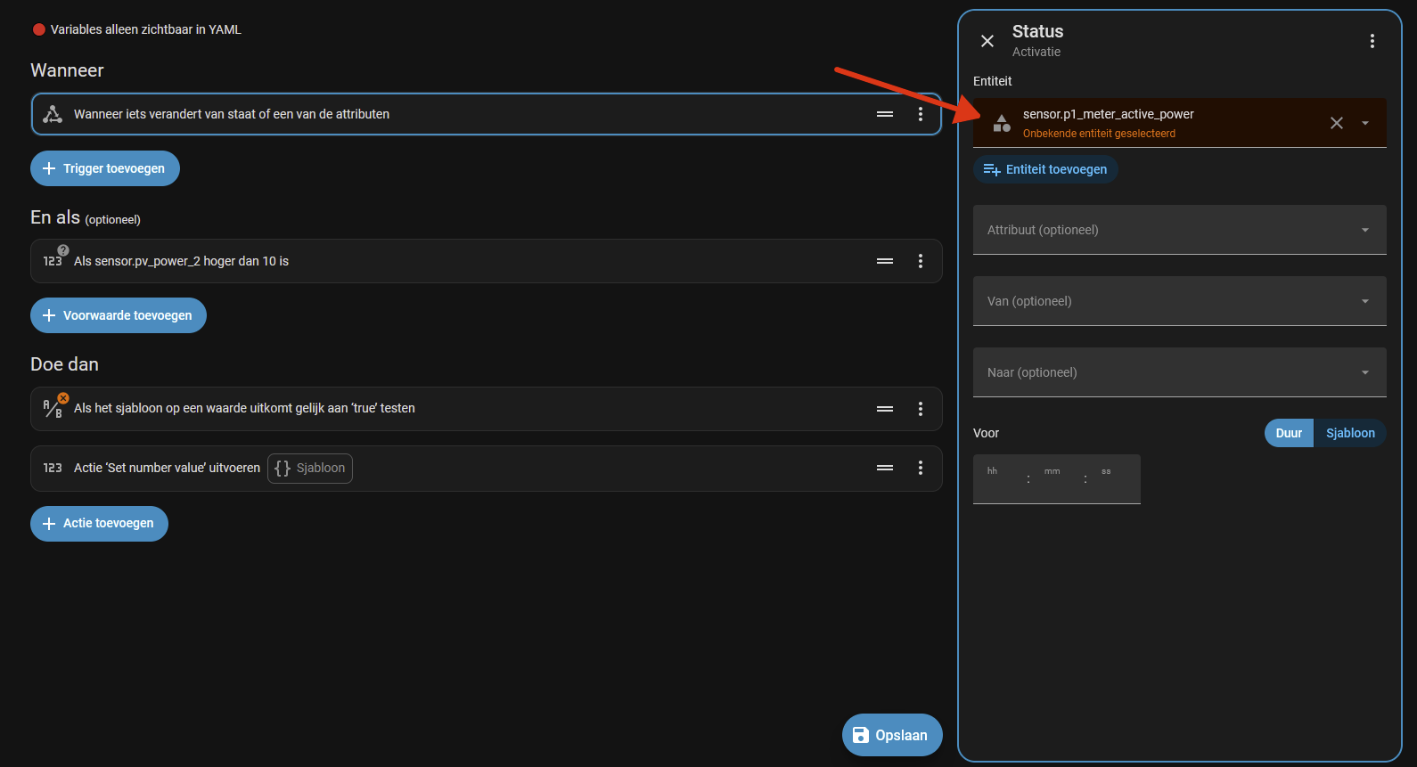

Hi, I hope this is what you mean.

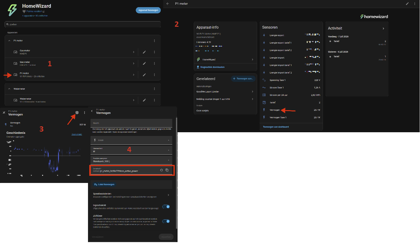

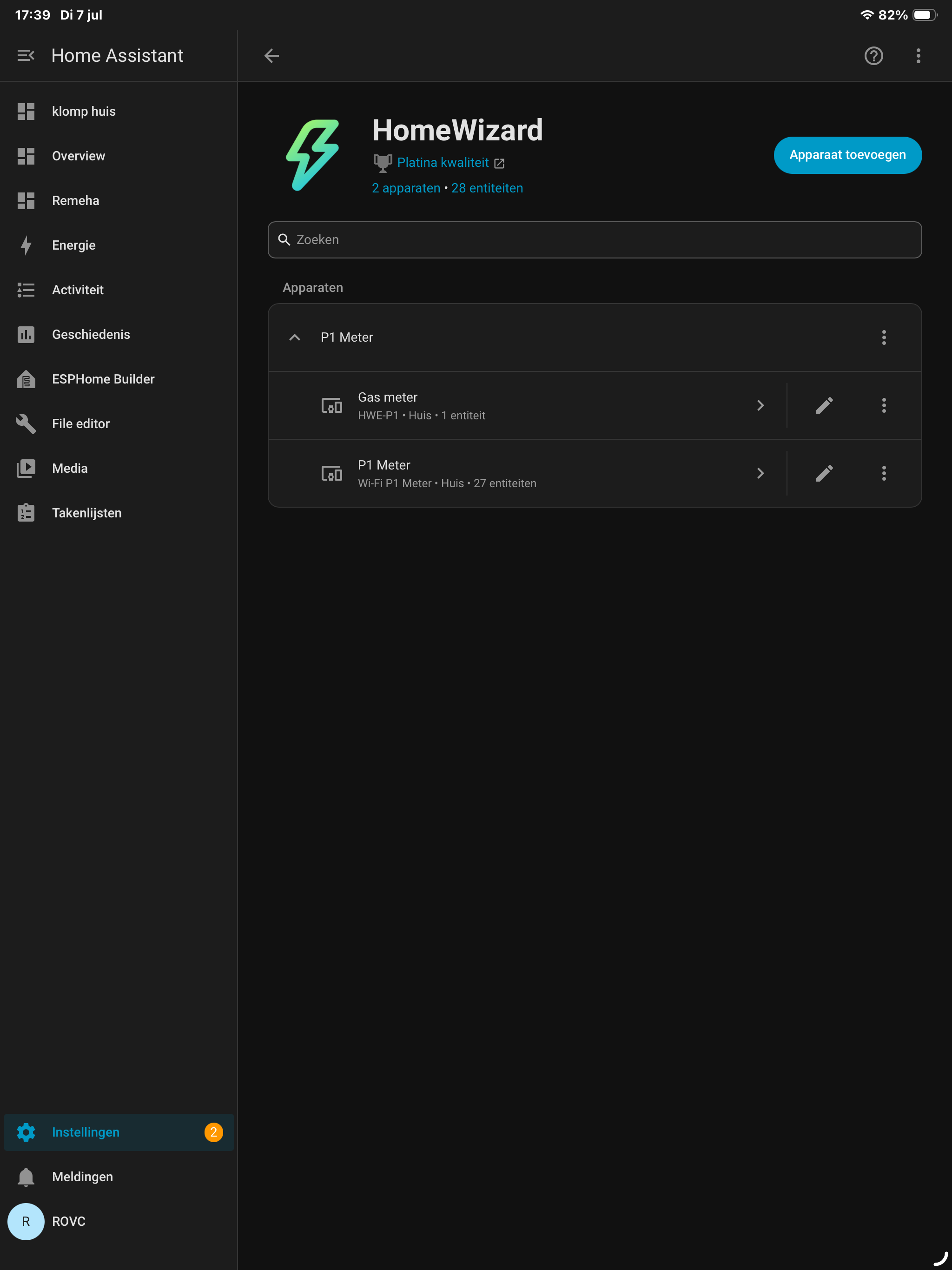

Please verify the entity name of the trigger. Select the correct P1 active power sensor
After that you need to change the "p1_entity:" variable also to the correct sensor name.
You can find the name of the sensor via Settings > Devices and services > HomeWizard integration
