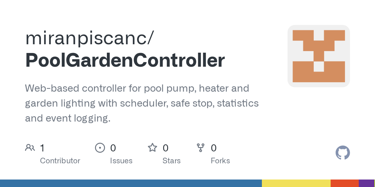

Hello everyone,
I developed an open-source Python project called PoolGardenController.
It is a web-based application that automates my swimming pool and garden, including:
• Water temperature monitoring
• Relay controllers
• Automatic pool heating
• Telegram notifications
The next step is integrating my GoodWe GW6000-ES-20 inverter to optimize pool heating using the available solar power.
