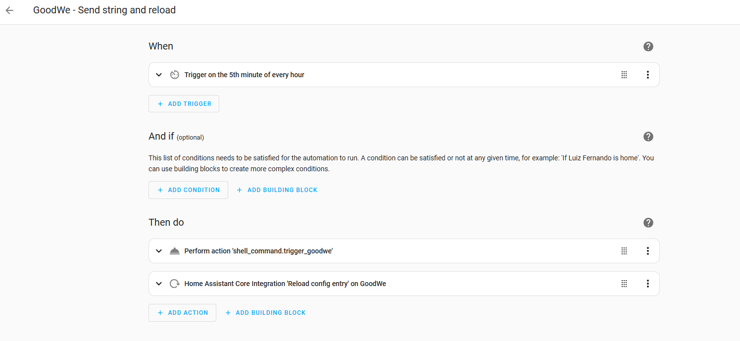

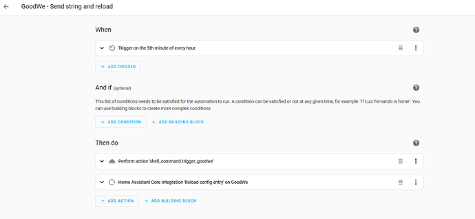

You can, alternatively, use “Automations” from the Settings section. Below, an image of it:
As you see, it was a “hammer and screwdriver” solution, as we say here in Brazil…
Any doubts, please contact me!

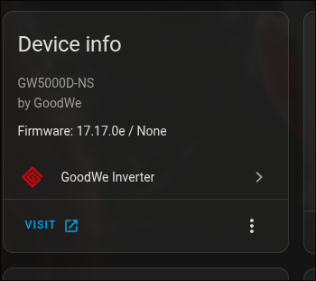

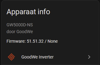

Is this related to a specific Goodwe device because I don’t have issues?
I’m using;
Edit:
I block communication to the world wide web for my Goodwe inverter. Local only.
My inverter disconnects at the end of the day because it essentially goes offline when it is dark and the solar system isn’t doing anything.
The integration automatically reconnects the following morning, however, without any intervention from me or the SEMS+ app on my phone.
Strange firmware mismatch between 2 identical devices…
Different regions might run different firmware to meet local electrical regulations, maybe… I’m in Australia.
Check! Dutch man here :wink: thanks for responding.
