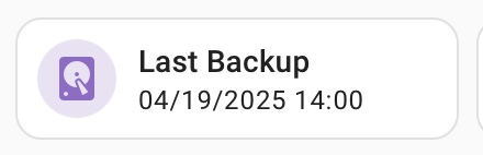

Picture of entity showing the date/day/time too complicated for me.

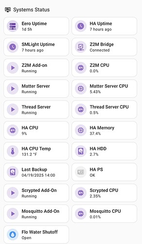

Picture of my dashboard of my ‘System Status’ section.

      {% set lastBackup = state_attr('sensor.backup_state', 'backups') | sort(attribute='date', reverse=True))[0].date | as_datetime | as_local %}
      {{ lastBackup | as_timestamp | timestamp_custom( '%m/%d/%Y %H:%M' ) }}
or you can simply create a helper sensor via UI… Where you just select last backup attrbute as source, select device class as timestamp for helper and you don’t have to worry about it in lovelace
Open your Home Assistant instance and show your helper entities.
thank you very much!!! VietNgoc, that did the trick, see screenshots! SO CLEAN, thank you!!
