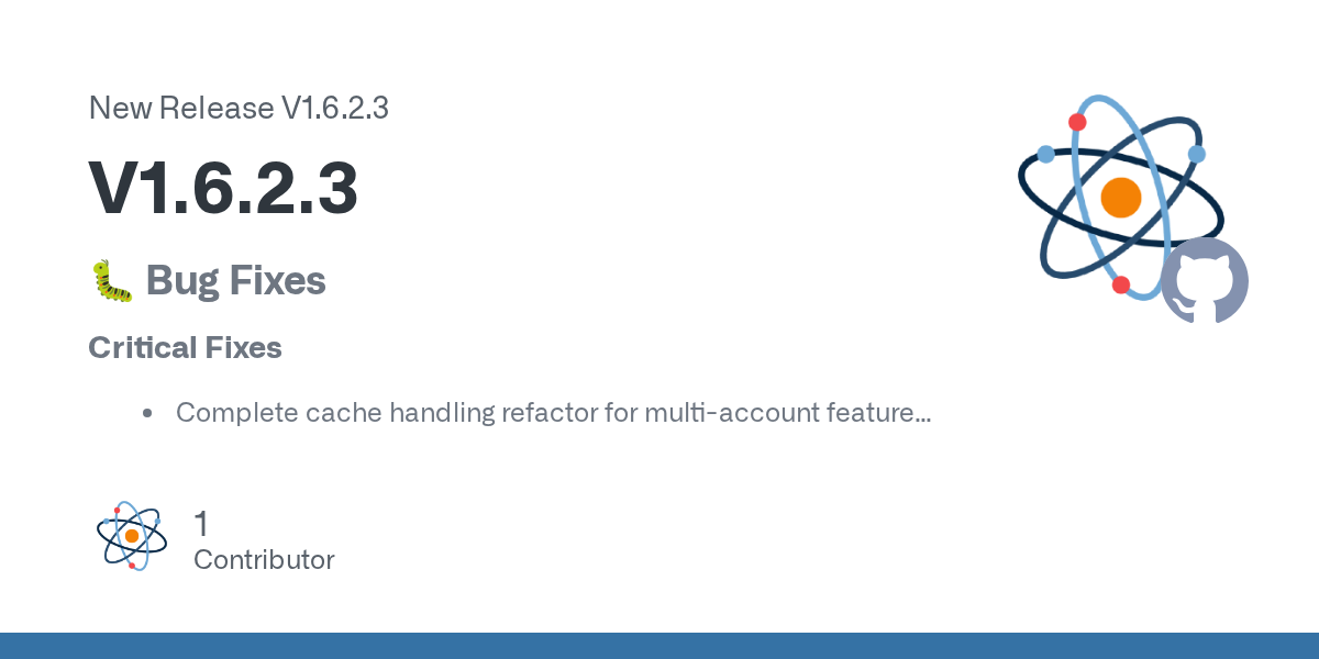

Please try updating to V1.6.1. You should delete your current integration config and add it again after updating to the new version
Nevermind, still working on a fix :unamused:
Alright, give the new pre-release a try…cache refactoring is a pain
I installed this version now, used my existing secrets and it seems to be working.

I have the same issue (“failed to connect to the google api”) with 1.6-beta4 and 1.6.2.3 version.
EDIT: fixed. I’d to regenerate secrets.json. HA logs give me the clue (the error message of the integration is not accurate)
