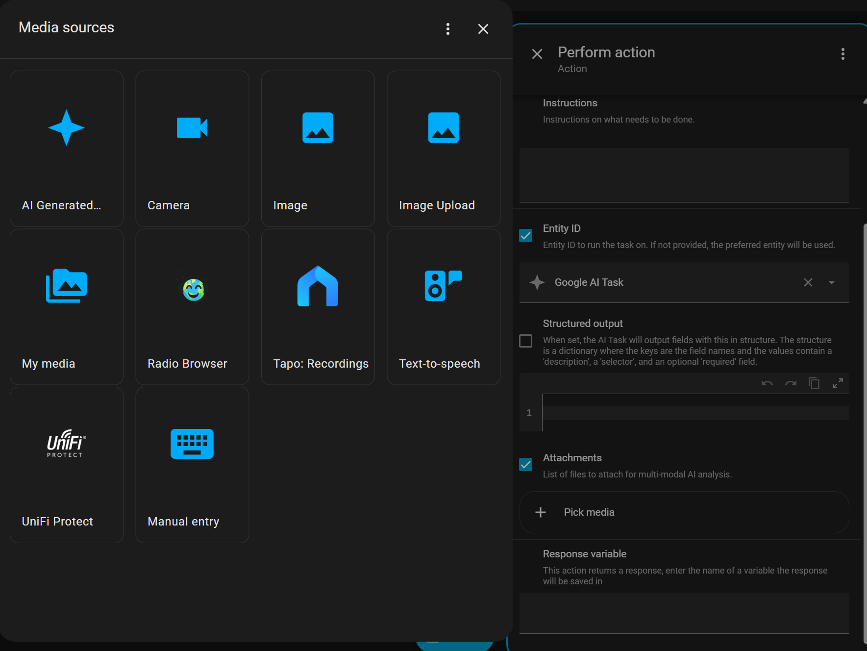

I`m a little confused on how to add the /config/www/proxy/XXXXXXX.jpeg file, I looked at the docs and it seems only media is able to attach from the build in media HA interface ?

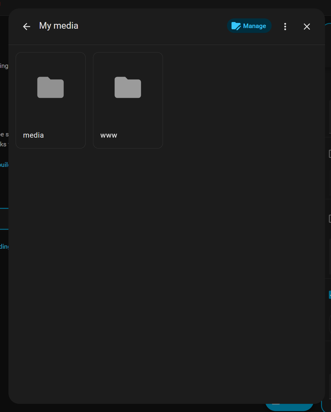

@stev3 this is really easy fix.
1) Map your folder in configuration.yaml
If your image is in /config/www/proxy/…, map that folder (or the whole /config/www) under media_dirs:
# configuration.yaml
homeassistant:
  media_dirs:
    local: /media                       # keep default
    www: /config/www                    # exposes ALL of /config/www
    # or, if you prefer just the proxy subfolder:
    # proxy: /config/www/proxy
Then Restart Home Assistant (or Developer Tools → YAML → Reload core configuration if offered). This makes your folder appear in the Media Browser and gives it a media-source name (www or proxy). Home Assistant
2) Reference the file in your AI Task
Now attach the file with a Media Source URI:

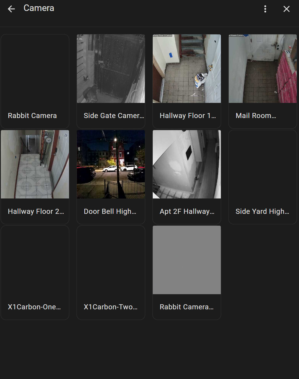

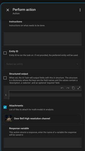

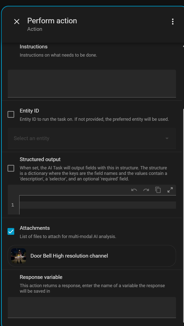

However id simply adjust my automation to snap a picture directly from the camera as its easy to do now. (Correct me if i wrong you use to capture snapshot then save it to www under the same file name every time then reference that in google generative ai?)
wow you are great ! Yes I take a snapshot and save it to the folder and then reference it in the AI task. I did see that you can take a snapshot directly from the camera using media now, but I want to send the same original snapshot via notification and email, does taking the snapshot from the ai task will save it somewhere and I can reference it in the email/notificaion ?
