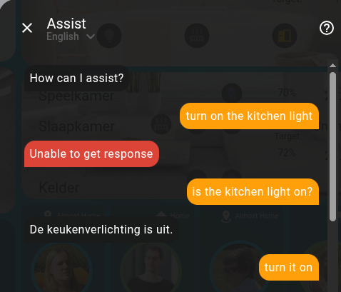

I have a weird issue with Google Generative AI (using recommended model settings). Most of my commands work fine, but some commands consistently fail with the error message “Unable to generate response”. Simply asking to turn on the kitchen light will almost always fail. If I ask if the light is on, it knows about it though and in a follow-up question is can actually turn it on.
In the system log, I get these errors:

Last content in chat log is not an AssistantContent: UserContent(role='user', content='turn off dinner table light', attachments=None). This could be due to the model not returning a valid response
Last content in chat log is not an AssistantContent: UserContent(role='user', content='turn off the kitchen light', attachments=None). This could be due to the model not returning a valid response
Last content in chat log is not an AssistantContent: UserContent(role='user', content='turn on the kitchen light', attachments=None). This could be due to the model not returning a valid response
Last content in chat log is not an AssistantContent: UserContent(role='user', content='turn on the living room light', attachments=None). This could be due to the model not returning a valid response
Last content in chat log is not an AssistantContent: UserContent(role='user', content='turn on the lights in the living room', attachments=None). This could be due to the model not returning a valid response
Any idea how I can understand what is happening? Interestingly, when I switch to gemini-2.5-pro, I get a more elaborate error:

According to that webpage, it would be a server error, hinting that the input context might be too large. But that seems odd since other commands seem to work fine? I do have 130 devices exposed though?
this wont help you but ion my case the situation is strange, if i try the same assist in phone it’s always returns unable to get response. if i go to assist in my computer, via browser, not app - it always works!
Same happening to me Last content in chat log is not an AssistantContent: UserContent(...
If gets fixed if I go to the integration (gemini), try to edit it, change nothing, save.
Also, it only happens when I use Assist via voice, by text the issue never happens.

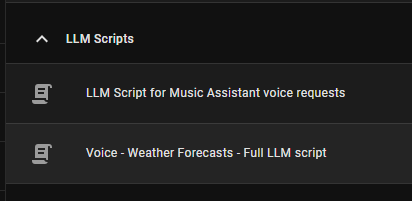

Here is the full error (minus tokens) if this means something. The request is really long, including all my home assistant devices and scripts. So I’m wondering if its a loading issue with Google that ChatGPT handles better per request.
  "candidates": [
      "content": {
        "role": "model"
      "finishReason": "STOP"
  "usageMetadata": {
    "promptTokenCount": 9639,
    "totalTokenCount": 9639,
    "promptTokensDetails": [
        "modality": "TEXT",
        "tokenCount": 9639
Side note, and its too soon to tell so I’ll report back, but I found a ton of the request was taken up by these two blueprint scripts I totally forgot I added a long time ago. One for Music assistant and one to get decent weather. I unexpesed them to the LLM and my Google responses started working. Not sure its whats in them vs just the added bulk they make to the request I send that causes the issue:
