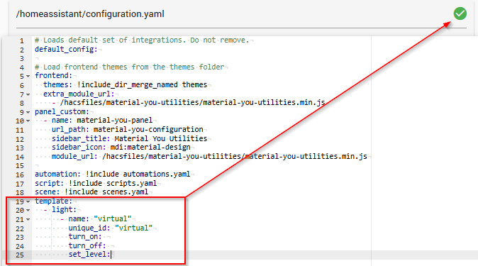

Sorry for having to ask again, I’m an absolute beginner. Pasting your coding for the bulb into the config brings (expectable) error messages. So I tried it with the GUI: Helper → Template → Light Bulb and as actions the delay as I don’t want to mess my config. But the status of the light bulb (the field under the name) is a mandatory field. When I enter TRUE, it’s always on. ENABLE makes it unknown. You can’t leave it empty.
What do I write here?
Thanks and cheers
The joys of Home Assistant: :slight_smile: The UI helper is very fussy and does not like creating a “blank” light . I haven’t found a way of creating one that works correctly .
You need to create the light manually in the configuration.yaml file. To do this, add the file editor “App” from Settings, App.
Once added, open file editor and find the configuration.yaml file in the left-hand list . Click on the three dots and download a copy of your configuration. yaml . This will be a backup “just in case”. Then open the configuration.yaml file. YAML files are dependent on the spacing in the file; be very careful with the spacing and changing the file layout. If the spacing is wrong the file will not work !
Look for the template: text in the 1st column of the configuration.yaml. Hopefully this is missing (if not, show me what settings you have there) . If so, go to the bottom of the configuration.yaml and copy the text for the virtual light (use the copy option in the top right corner of the text box). Make sure the spacing is consistent with the rest of the file (the file editor should give a warning if the spacing is illegal; there will be a green tick in the top right corner if file good) ; if not, adjust the spacing. The template: must be in the first column. Save the file.
Go to the developers’ tools in the settings menu and click on YAML, then click on the check configuration file. If this is OK, look down the list of YAML configuration reloading and click on Template entries. This will load your template: and the virtual light should be created !
Any errors show me your configuration.yaml (redact any passwords etc)

When I paste your bulb coding starting from line 19, I (still) have the green checkmark top right. This means that the config will still work?

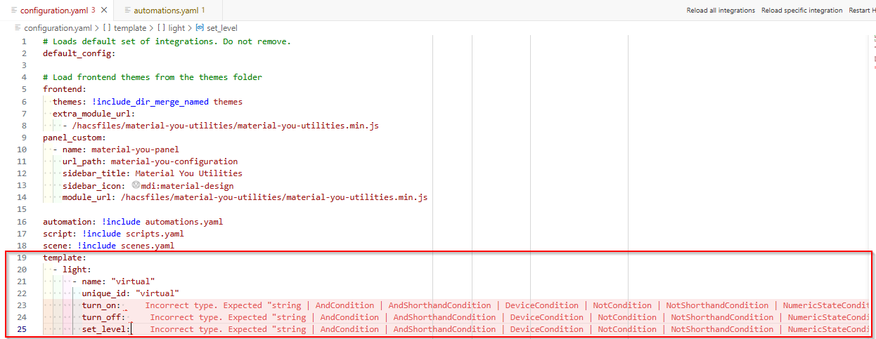

EDIT: New users can only put one embedded media item in a post, I have to split this answer.

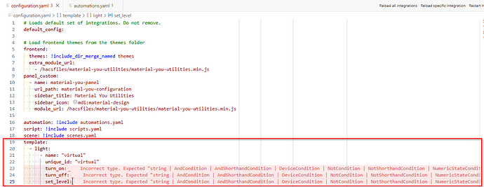

Because I used the App “Studio Code Server” before and pasting it there, it gives me the following errors:
And I’m not even sure if I can save the config at all (in SCS).
Config is fine. Save the file with the file editor and test with the developers’ tools. If the developer tools say, “Configuration will not prevent Home Assistant from starting!”, then you’re good; you won’t break a restart. Don’t restart until you have checked!!
I think the Studio code is using the same syntax check as the UI Helper, doesn’t understand why you want a light that does nothing!
I will load Studio Code Server and test on my setup. :slight_smile:
OK tested with SCS. Change the lines in error to the following:
        turn_on: []
        turn_off: []
        set_level: []
omg, it’s working! Thank you so much! Not all heroes wear capes :slight_smile:
