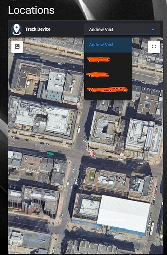

This card is great and i am loving how it is far superior to the map card, however the way the entities are added i am struggling to get tit to work with a person selector drop down box.
I have got it working on selecting a person to show the current location, however i cant add any of the variables that are entity specific.
Below is what i currently have
However i want to be able to see the historical routing like in the picture below
Now i don’t know if this is something that can be fixed in the custom:card_templater or the map yaml itself but any advice on how to fix it, or an alternative solution would be greatly appreciated

Thanks in advance for any help given.
Andrew

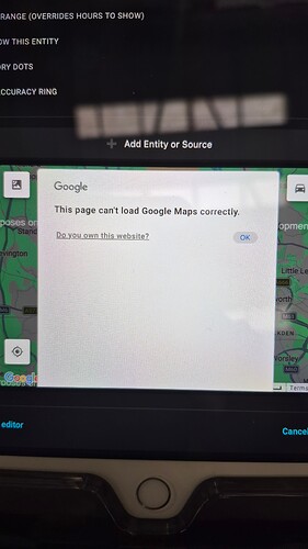

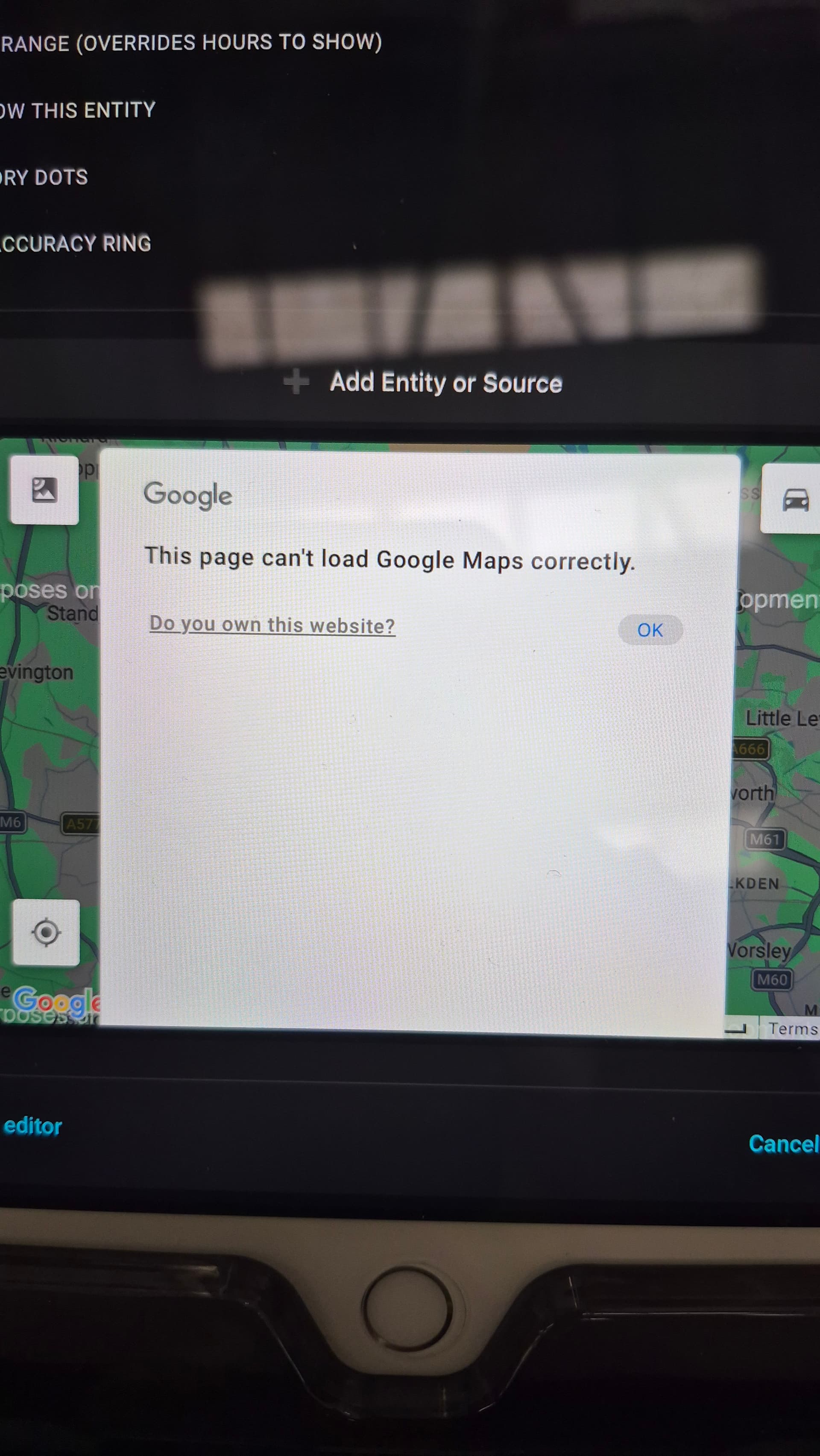

Hican someone help why am I seeing this?
Please check API settings. I also respond your issue on Github
