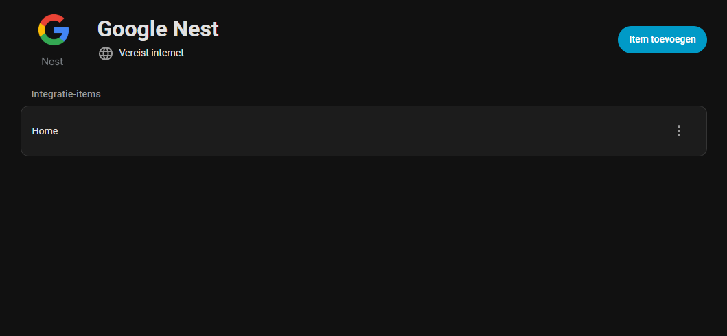

Mine was working fine a couple of days ago, then out of nowhere it just stopped working. I’ve tried to set it up at least 10 time and all I’m getting is home and no entities.

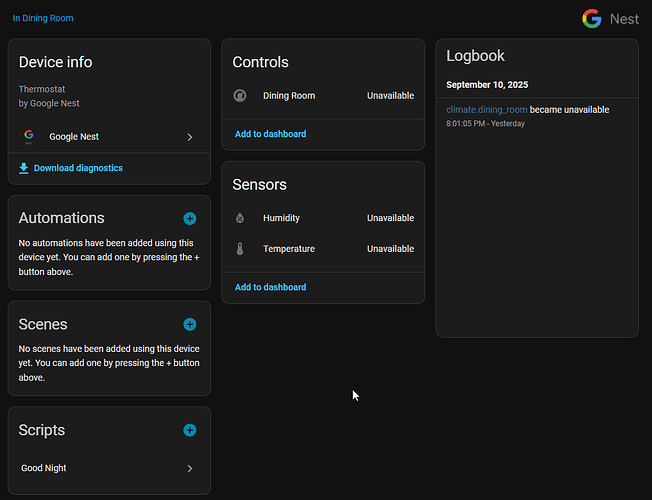

Same issue here. Thermostat entities are no longer available
That’s exactly what happened to mine, reconfiguring made it worse :tired_face:

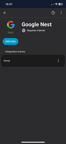

Same problem here. Dont know when it started. Maybe after update thermostat end of august or after latert update home assistant?

I have also just had the issue of the entities missing. With it just showing ‘Home’. As per others users.
This happened to me, i had to toogle on some values here: https://nestservices.google.com/partnerconnections
Seems reelated to room where Nest is located in nest/home app. Just activate all and integration should have device with the 3 entities again.
Yes, this did it!

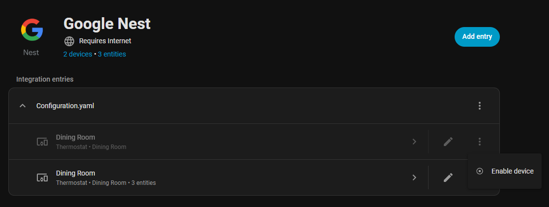

Google Nest permissions were already toggled on. I removed the thermostat from the Nest app and re-added it, then toggled the permission back on as it was off now. The thermostat is available in home assistant again after reloading the integration but the old thermostat entities were still showing, the “new” thermostat had _2 added to the entity ID’s. I manually removed the old entities and renamed the “new” ones to avoid having to reconfigure all my dashboards and automations.
One detail: the integration is now showing two devices (one of which I removed the entities). I disabled the “old” thermostat device already, however I’m wondering if there’s another action I can take to completely remove it?
