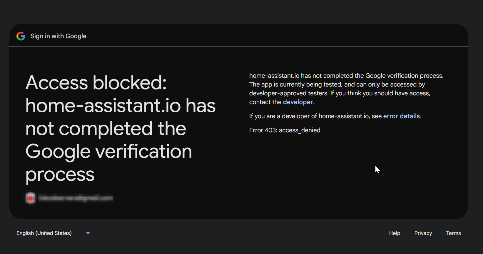

Hi. First time setting up HA specifically to manage Google Nest Thermostats.
I followed the directions but get this during the process.
Any help/suggestions appriciated.

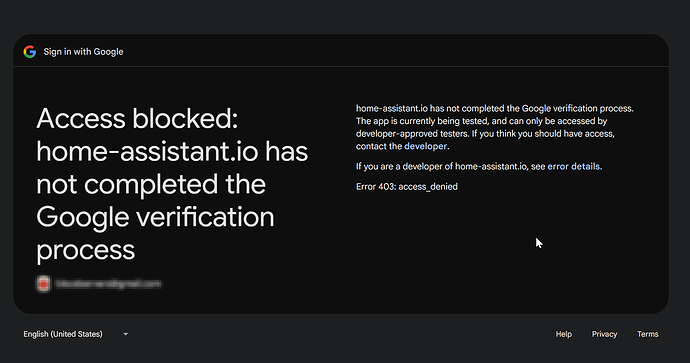

I’m running into the same issue 10/26.
try this
i had to go in and add my email address as a test user. that fixed it.

I’ve just set up the integration from scratch following the prompts in the integration dialogs. A lot of jumping around Google Cloud config pages but not too hard to follow. The only part that wasn’t clear was to add myself as a test user under OAuth/Audience as @bigjim21 says above.
