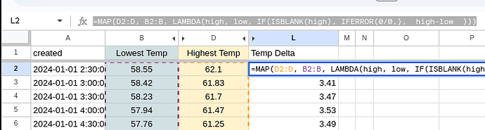

Just to clarify, the formula does not go in the automation, you just put it in the sheet in row 2 of whatever column you want. Here’s an example where I get the delta from 2 columns:
The formula is as follows:
=MAP(D2:D, B2:B, LAMBDA(high, low, IF(ISBLANK(high), IFERROR(0/0,),  high-low  )))
If you look at the screenshot above, you will see that row 1 contains headings like “Lowest Temp” and “Highest Temp”:
Those correspond to the data keys in this action

The action doesn’t care what order they’re in or what column they’re in, it just fills the new row matching the data key to the column heading. So if you want the 2 tariff consumption values posted to the same row of the same sheet, they need to have unique names…
