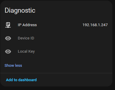

This integration automates that whole process: you log in once with your Smart Life account via QR code, it retrieves the device ID and local key for you automatically, and from that point on it talks to the pump entirely on your local network. No cloud involved afterward, and no Tuya developer account needed.

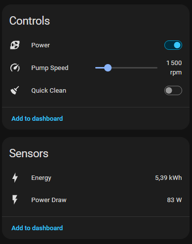

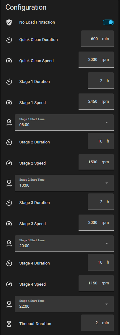

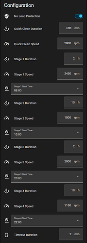

  • Entities: Power and Quick Clean switches, No Load Protection switch, Pump Speed, Quick Clean Speed/Duration, Timeout Duration, and per-stage (1-4) Speed / Duration / Start Time controls
  • Power Draw (W) and Energy (kWh) sensors, computed by the integration itself from the commanded RPM and the pump model chosen at setup

  • Automatic recovery if the pump’s IP address changes (no static IP assigned, router reboot, etc.), plus a manual Reconfigure option under the integration’s device page for fixing it immediately yourself
