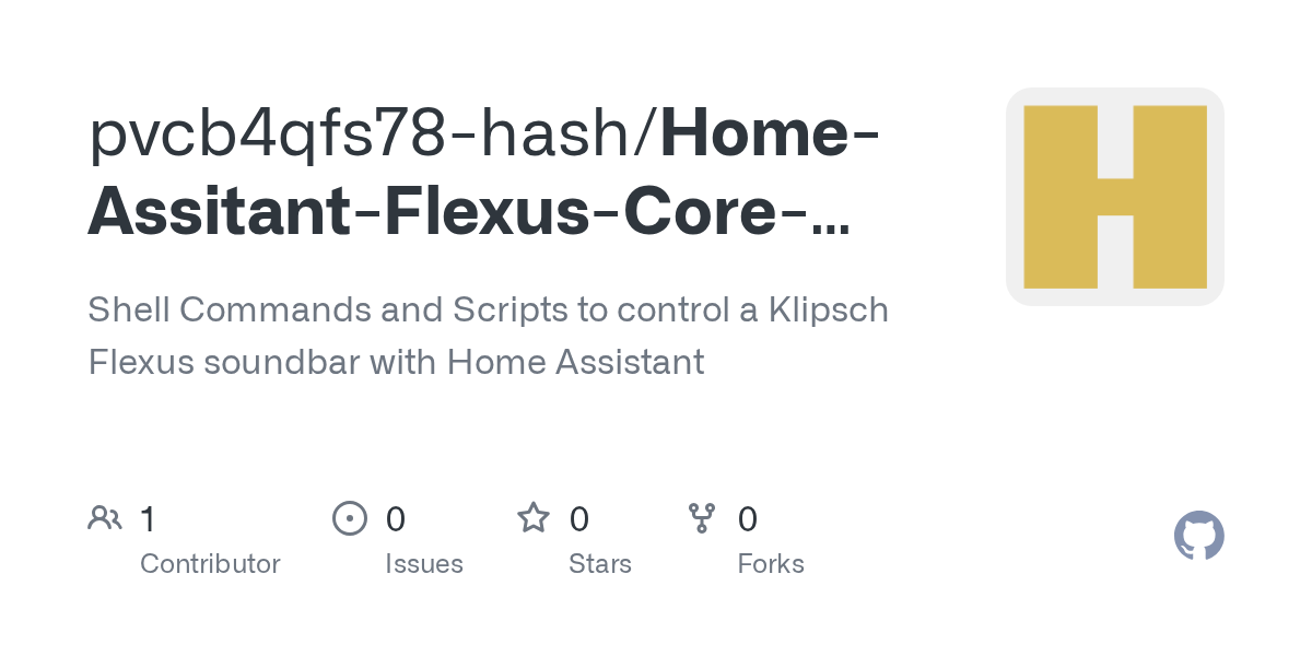

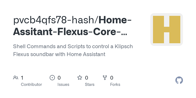

Files with both the Scripts and the Shell Commands are on GitHub here:
