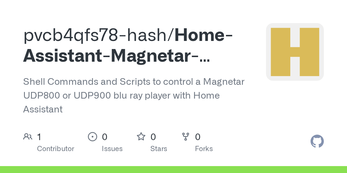

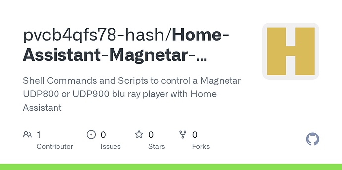

The file with the Shell Commands as well as the script file are on GitHub here:
