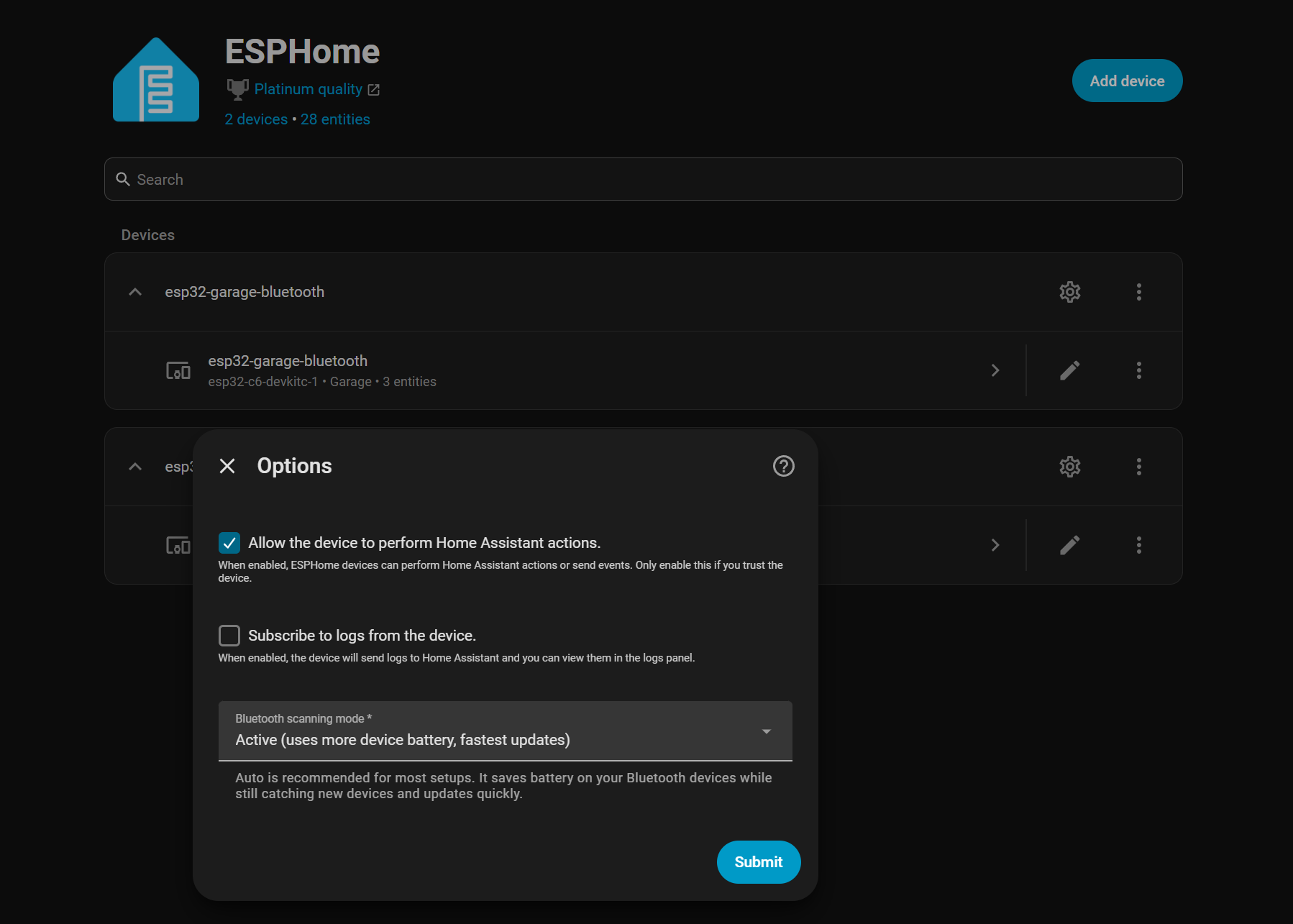

For esp bluetooth scanning I had same issue. This setting is under ESPhome instead of bluetooth
Fixed it for me to force it to active. At first I did not find the setting as documentation only mentioned Bluetooth component.
Hey @Dennis87 that's it!!!
Yea the documentation is incorrect, like you found it is in the ESP32 intigration, was driving me crazy as the cog was just not there in the Bluetooth settings.
Thank you mate :oncoming_fist:t2:

@priyo1 I was able to get my 5074s to ingest reliably with one nearby board manually set to Active scan under /config/integrations/integration/esphome. (I also just got some 5100s to test and have been much happier so far, they transmit temp as part of their passive advertisement and the batteries are cheaper to maintain, so I think they're a double win overall.)
