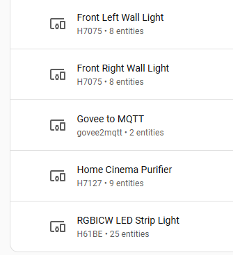

Anyone here got the H7127 air purifier to work?
I have installed the gove2mqtt add-on and it detect my lights just fine but not the purifier, any ideas?
Did you restart the addon when you added the H7127?
Yeah picked it up after, but maybe because I added the api key?

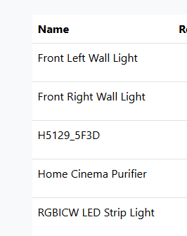

Only thing still missing is the motion sensor
Shows up on the addon, the H5129 item but it does not exist in mqtt as an entity, like the others do
Is it not supported?

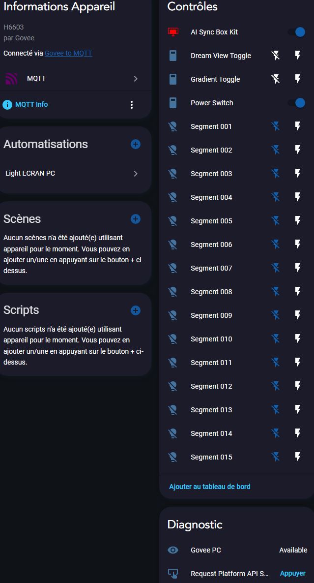

hi all
i receive e h6603 govee
i see it in govee2mqtt
but icant see some option like :
i have a h6603 and same thing not all “option” do you find a solution please
