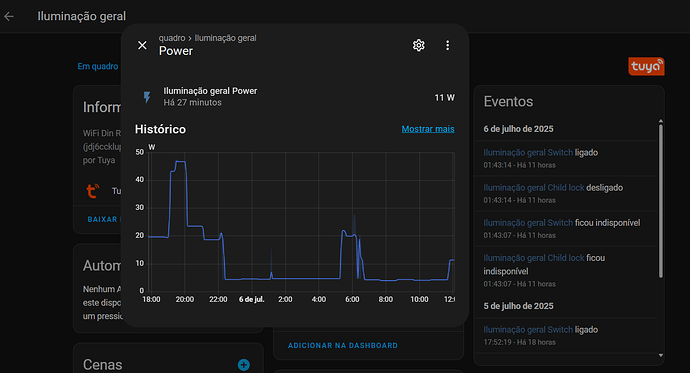

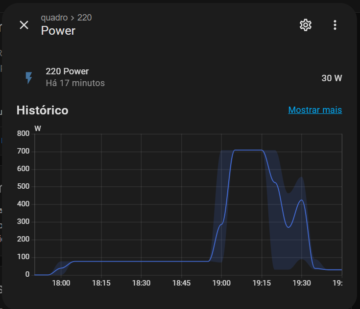

so I asked chatgpt how to change the sample period of the graph, it told me to use scan_interval, so I asked to change the code of the card, but it said I had to change the sensor configuration, so I asked where was it, and said that I have a tuya WiFi Din Rail Switch with metering, then it said that tuya integration collect the data automatically, and I couldn’t change it’s sample period, but then when I opened the device I saw this graph

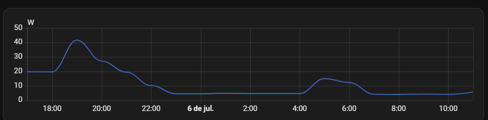

which is already a very good graph, but I cant show it on my dashboard, and I don’t know what I’m doing wrong and even how to ask for chat gpt for help.

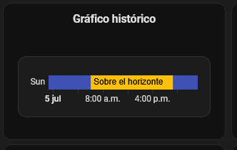

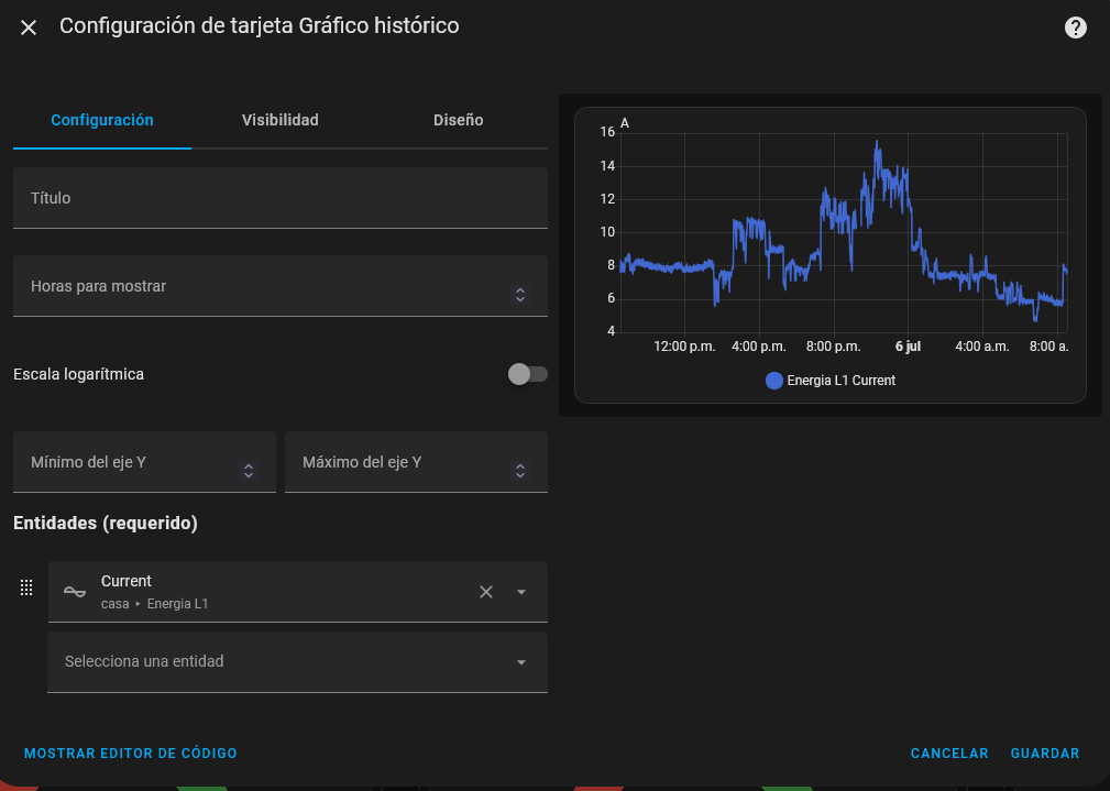

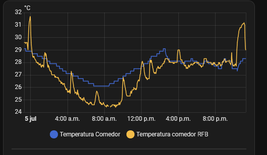

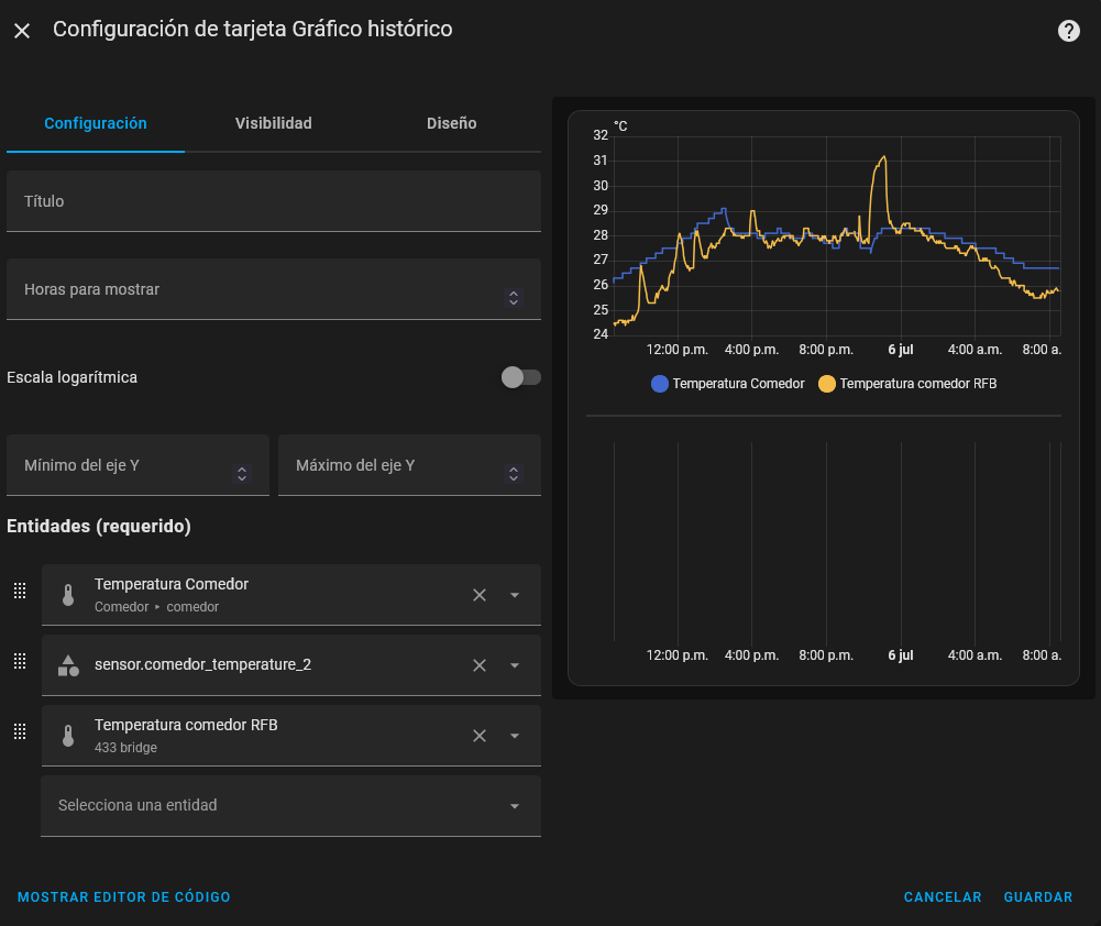

use historic graph
when you use a sensor like power meter will showe you the graph
like this one
if you add multiple sensor you will get something like this one

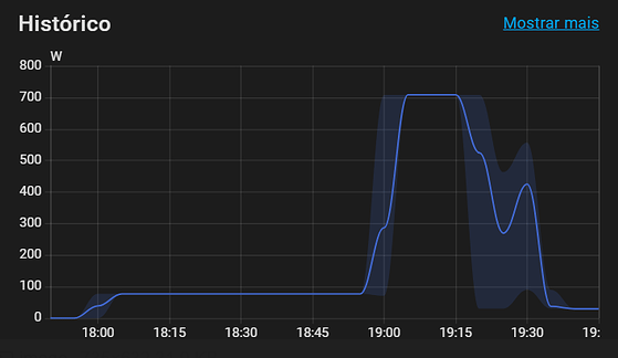

But I still miss one thing that is the min, max nd average vallue that shows when acess the sensor thru config → enitities
you dont need a yaml as this is a already normal card
theres noting fancy
If you like the chart in the more-info, that’s probably statistics with a 5minute period.
That is the finest resolution that statistics collects, and it is not stored as long as hourly statistics, so you will be limited to the length of data-retention in your recorder (default 10 days) for a 5minute graph.
Hourly stats are retained forever though.
But you can get that graph by changing your period to 5minute.

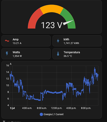

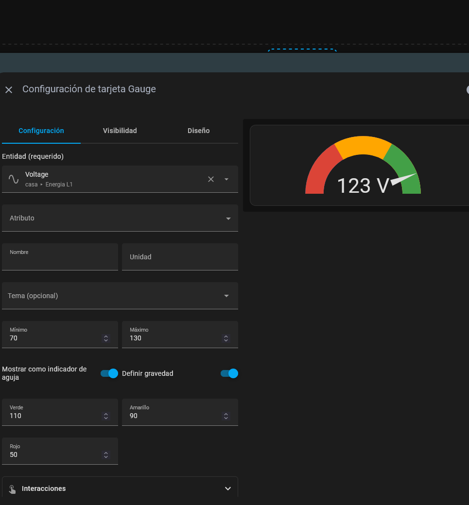

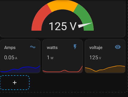

the first one has something fancy, with red yellow and green indicator of voltage
I was referring to this:
The red/yellow/green card is a Gauge card
change to 5 minute period is exactly what I was trying to do

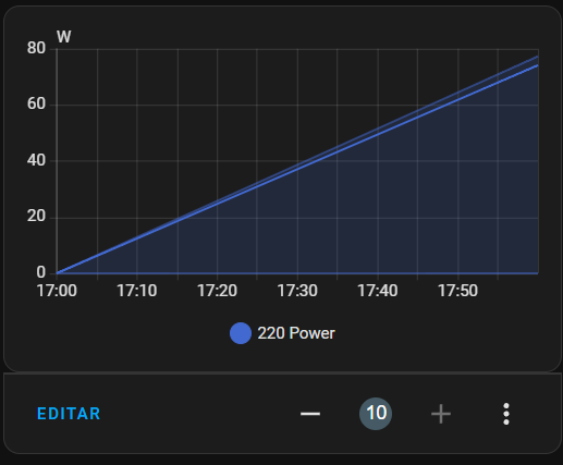

yes, i´d like this graph on my dashboard, if I use chart_type:line it stayes horrible like this
it gets a litle better
but it still with 1h sample and it isn’t quite good like the one in config wich has a 5 minute sample

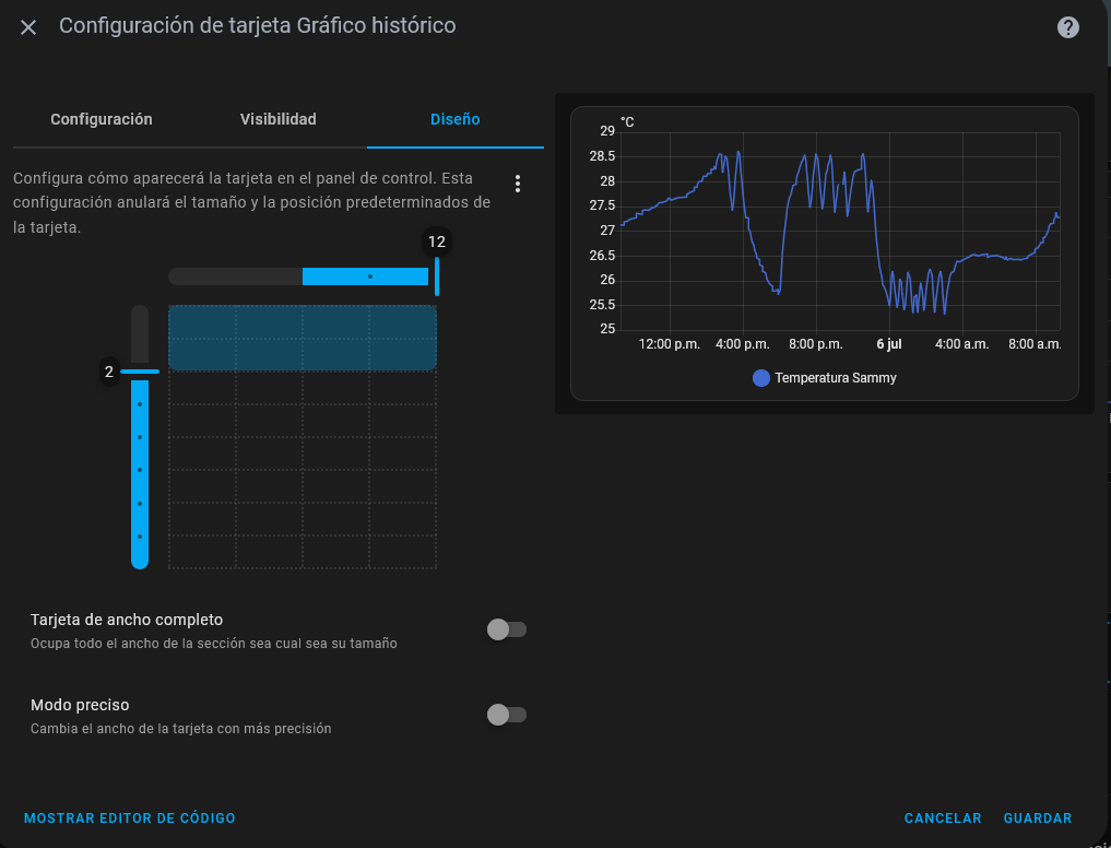

you can change the size on the design tab
on HACS you can have other types of graphs like mini-graph-card, apexcharts-card ,apexcharts-card
