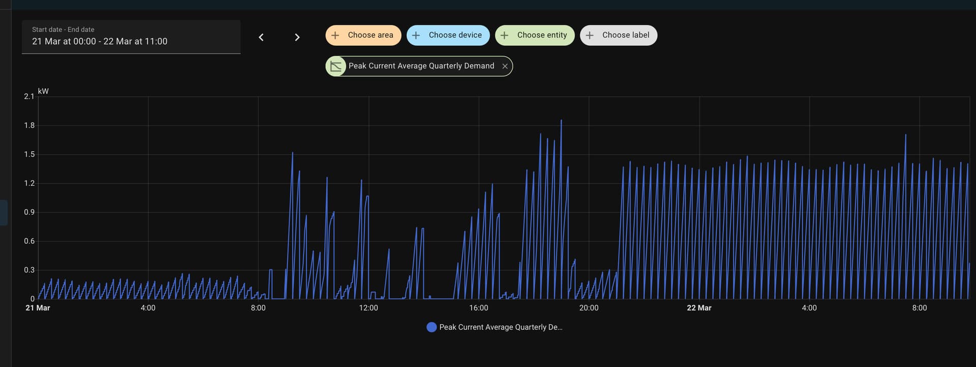

I’d like to have a graph that only shows the peaks of this graph. What would be a good way to do this?
Reason is when you just click the entity, the default history graph is a bit misleading (notice the dark blue actual max peaks are more difficult to see):
Thanks!
Thanks, thing is, I need a bar to be every 15min as the usage is reset by my electricity meter every 15min. That seems not possible with the stats graph card for some reason.
You’ll need a 3rd party card like ApexCharts or Plotly.
