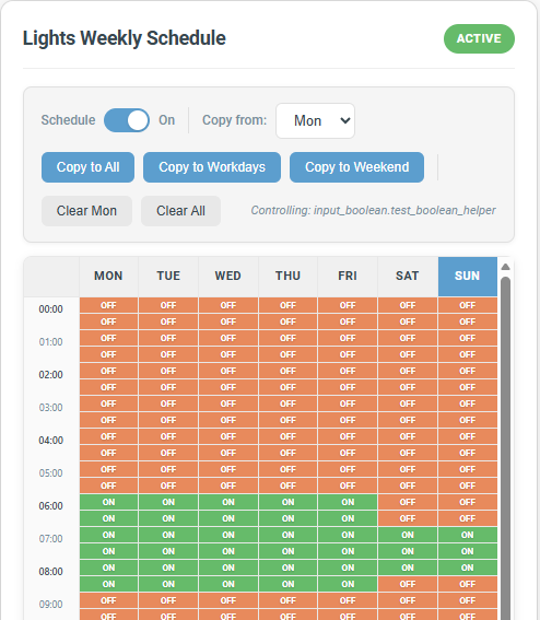

I’ve created a graphical scheduler where you can easily schedule things to be turned on or off, or values (e.g. temperatures) change at a certain time and not via other triggers. I wanted to make it simple so users don’t need to be tech savvy but could still adjust the schedule in the frontend. So, now it’s here hb9hkn/weekly_scheduler_card: – it can be installed through HACS (you have to add a custom resource) by downloading the integration and the card.
The frontend has 30 min slots, however using the services you can choose any time you want via yaml.

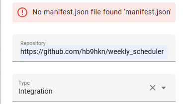

I tried to install it using hacs (version 2.0.5) but I got this error:
In the hacs debug logs I didn’t find anything relevant:
<Integration hb9hkn/weekly_scheduler> Checking repository.
<Integration hb9hkn/weekly_scheduler> Running checks against v0.4.1
When installing the card repo all was fine.
I think the problem is that in the hacs.json you have the content_in_root set to true while it should be false. Can you double check?

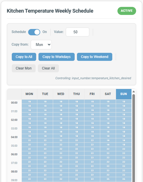

I was testing it a bit because I think that might be useful for my use case where I want that other people in a housa can manage the heating in their own rooms. So, here is my feedback:
- When using it in a mobile device it is very easy to change unintencionally the schedule. When I am scrolling down, if I clic in the schedule I can change it by mistake. I think that a double clic or long press would be great to avoid this problem
- I think that hide some fields like “schedule on/off” might be interesting
- When using input_number, if I clic over a timeslot that is already defined it updates to the new value but there is no way to reset it back to null. This is not a problem but if reset is not possible I would consider to have all timeslots with a predefined value by default.
- I would like to have a button-card with a schedule icon and when this button is pressed show this card so the user can modify it. I think this is no going to be possible and that the only options are browser_mod or navigate. I don’t like to use browser_mod because I would need to register browsers etc so I guess the only option is the navigate action and design a new panel where I have this card and a back button. What do you think?

Thanks for the feedback and proposals. It is the first release, so I’ll be improving it. Unfortunately, I’m going to travel for the next couple of weeks and won’t be able to work on it, but will continue when I return. Comments:
- Yes, it is extremely easy to change the schedule on a mobile. I was thinking about adding a button for mobiles to ‘indicate’ the wish to change schedule or something like a long push. I need to play with it a bit.
- Hiding some fields: yes, good idea
- Reset input_number: I had this before, but then the question was to what number would the reset go? Initially, I had it setup that if a field was empty, then the last defined value was held over. This led to confusions because the value was not visible, but still defined. If you have a proposal what to do with the “empty” fields please share – ‘null’ might break automations or other actions triggered by the value change.
- I don’t like the browser_mod either. I created subviews on my dashboards. So the main dashboard has a button which leads to a subview which has the schedule. I don’t know if this could work for you.

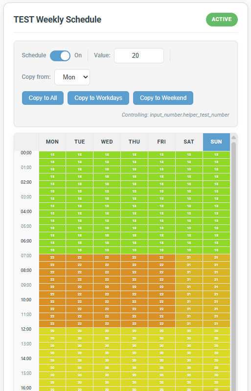

A great plus would be to be able to set color thresholds for different values. This would make different blocks in the schedule more visible. Now all temperature values are blue, and it is hard to see when a schedule stops and another one begins.
Good point – I’ll try to come up with something in the next version.
BR
Hi, folks,

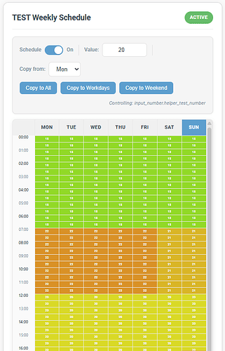

I changed the numerical scheduler card so that the values are colored around the color wheel. Optionally, you can define the min and max value, in which case the colors will be spread between these two values. Otherwise, the min and max in the table are taken as the extreme values.
