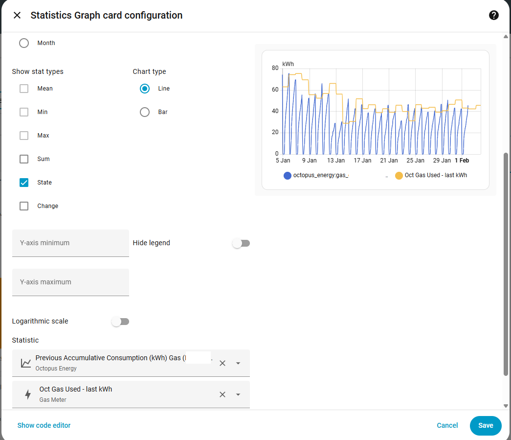

This graph shows the difference between the two “entities”.
The yellow line comes from the standard “sensor.octopus_energy_gas_accumulative_consumption” entity that exists in Home Assistant with a state value that is updated once per day, and shows the total consumption for a day before. In my case, the readings are coming in two days after, so the reading updated early today (3rd Feb) is for what was used during 1st Feb.
The blue line comes from the “octopus_energy:gas_accumulative_consumption” extra ‘entity without state’ that has been back-added later by the integration, and hence there are 24 hour records for the 1st of Feb, showing the use hour by hour up to the total that matches with the sensor, albeit a couple of days later.
As far as I know, there is no way to do this in Apex Graphs, so you should use this card instead.
