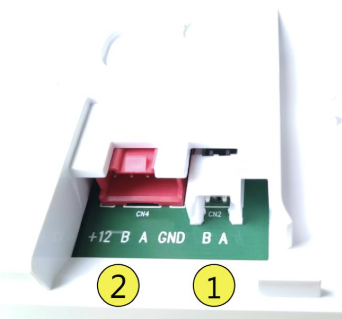

did you figure out the connector name? There is unanswered question in Reddit about this as well https://www.reddit.com/r/homeassistant/comments/1769rp8/does_anyone_know_what_connector_type_this_is/
I can’t find it anywhere…

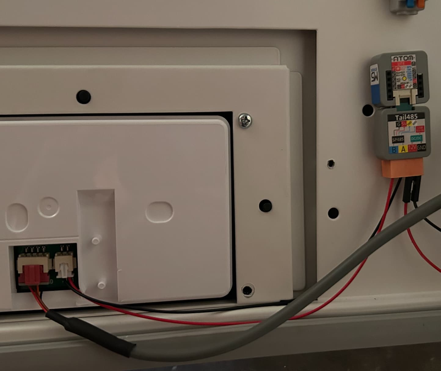

Never mind, I was able to somehow fit JST XH 2.54 mm 2-Pin Female Connector.
I’m using M5Atom Tail485 - RS485 and M5Atom Lite.
Sorry for the late reply… I did not, but I found some extra cables laying around and one of the connectors was almost there, but it had some extra plastic… so I used knife to cut it… now it works :smiley:
So with this setup you dont need the 120 ohm resistor? Where does your power come from?
I’m using power from the panel connector (number 2 in the screenshot).
It works fine for me without the ohm resistor.

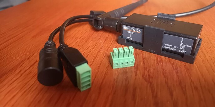

Do you think that I can get the power for an Elfin EW11A too? (Input: 5-36VDC@5W)
Possible, but you will have to splice the cable, since the 12V that are available on the left connector are powering the screen itself. Not hard to do, but not plug and play.
Ohh, it would be inspiring to see some image how you get the +12VDC from the panel.
Uhh, finally did it. :confused:
