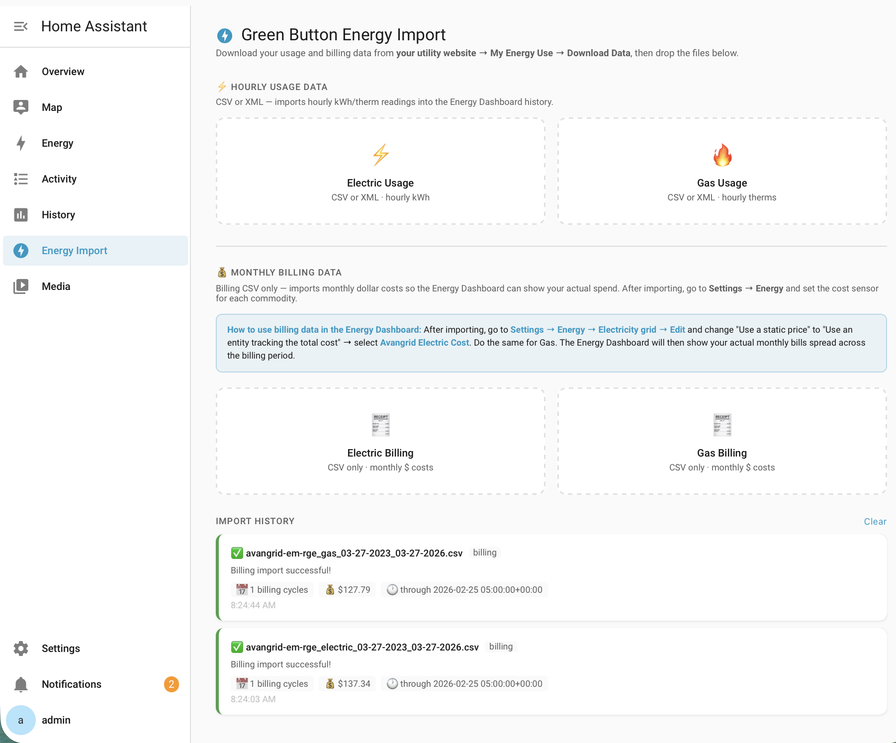

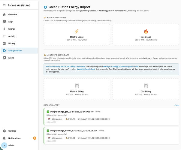

  • Drag-and-drop import panel — a sidebar panel appears in HA after setup. Drop your downloaded CSV or XML file onto it, and the data is imported immediately.

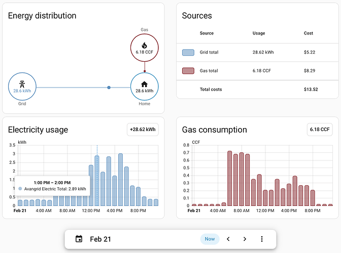

  • Full historical backfill — imports months or years of hourly kWh/therm data with the correct past timestamps so the Energy Dashboard’s history charts are fully populated.
  • Monthly billing import — import your monthly billing CSVs to populate the Energy Dashboard’s cost view with your actual billed amounts instead of a static price estimate.
  • Safe re-imports — duplicate rows are automatically skipped. You can re-drop the same file without creating duplicates.
  • CSV and XML support — works with Avangrid’s Opower CSV export and standard Green Button ESPI XML exports.
  • No YAML required — set it up entirely through the UI under Settings → Devices & Services.
