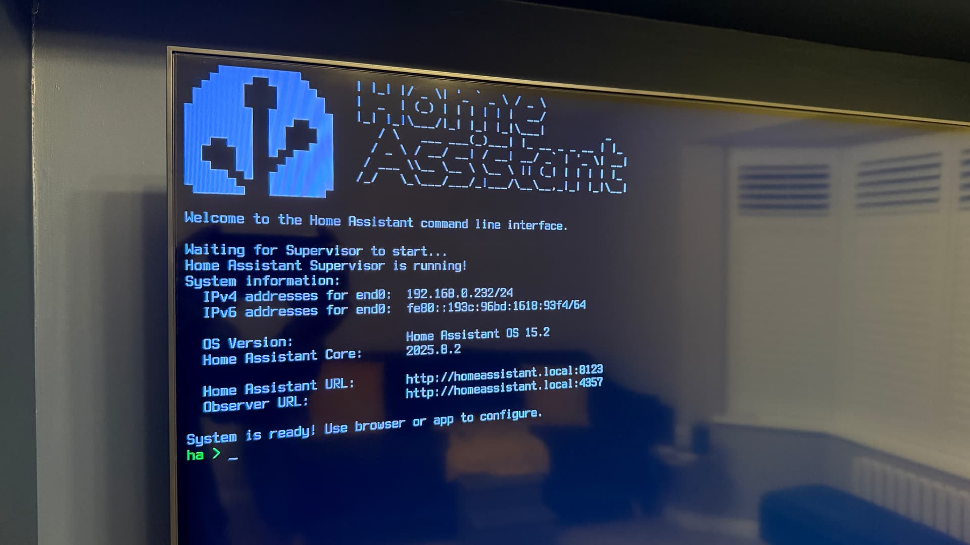

Can you connect a screen to the green and show a screenshot ?
Try http://192.168.0.232:8123 in a browser.
