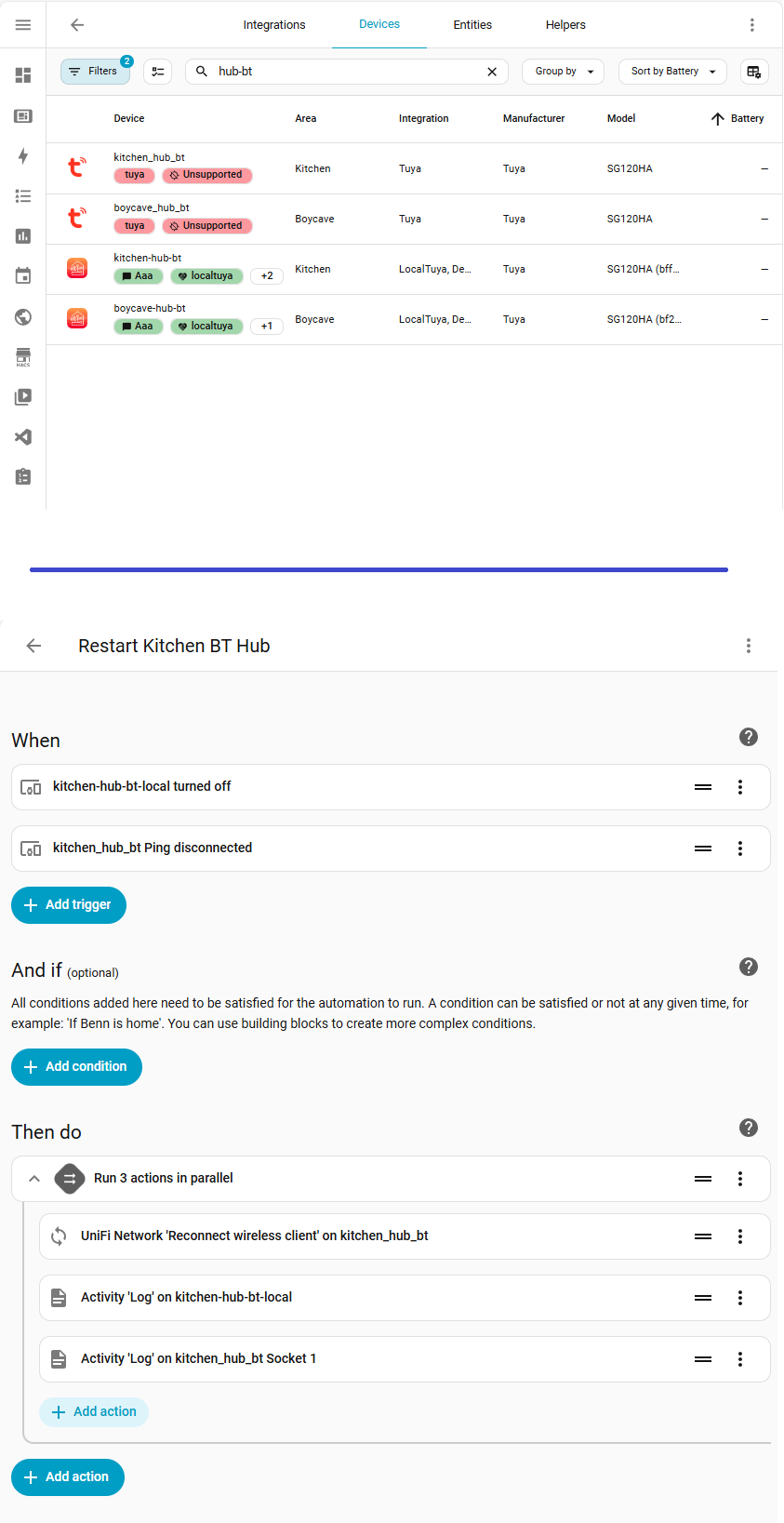

I have the same thing. It looks like a firmware issue that Arlec hasn’t bothered to patch. I’ve used a combination of localtuya, tuya, devicepulse, unifi apps to do a work around. doesn’t fix the issue but, it minimises this being offline in HA.
alias: Restart Kitchen BT Hub
description: ""
triggers:
  - type: turned_off
    device_id: foo
    entity_id: bar
    domain: switch
    trigger: device
    for:
      hours: 0
      minutes: 3
      seconds: 0
  - type: not_connected
    device_id: foo1
    entity_id: bar1
    domain: binary_sensor
    trigger: device
    for:
      hours: 0
      minutes: 3
      seconds: 0
conditions: []
actions:
  - parallel:
      - action: unifi.reconnect_client
        metadata: {}
          device_id: foo
      - action: logbook.log
        metadata: {}
          domain: Wake-word detection
          message: >-
            Restart W-NIC on device via unifi controller. #Automation told me to
            do it.
          entity_id: switch.kitchen_bt_hub
        metadata: {}
          message: >-
            do it.
          entity_id: switch.kitchen_hub_bt_socket_1
mode: single

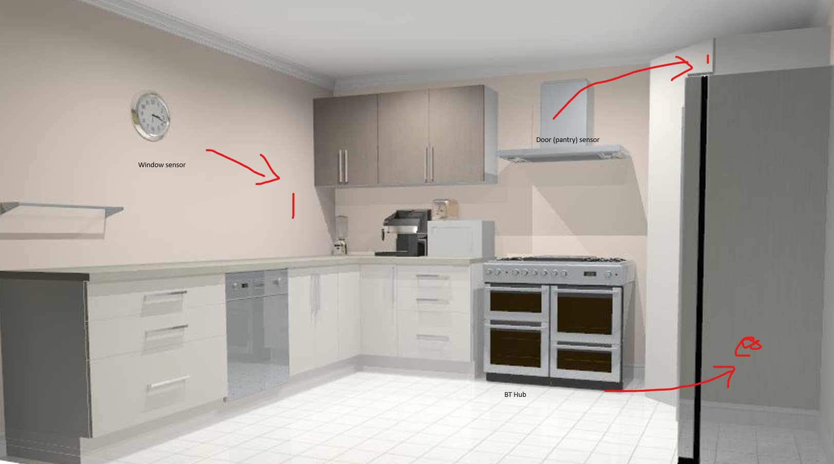

Also, it’s a pretty limited range requirement. >5M line of sight, with >5 devices (10 MAX per room). I’ve only got 2 BT Hubs setup as a test use case.
  1. Kitchen for door sensors to talk back to HA for Automations
  2. Office/Shed for door sensors and temp sensors for the same reason
I feel like realistically, it would be better to move over to a " Aqara Smart Hub M3" to have a unified IoT Hub moving towards Matter as the primary protocol and zigbee as a secondary.

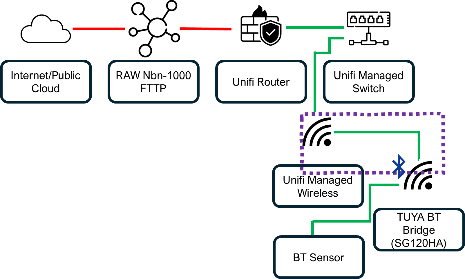

Here’s a 3D drawing from the original design

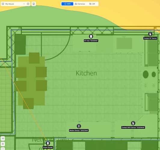

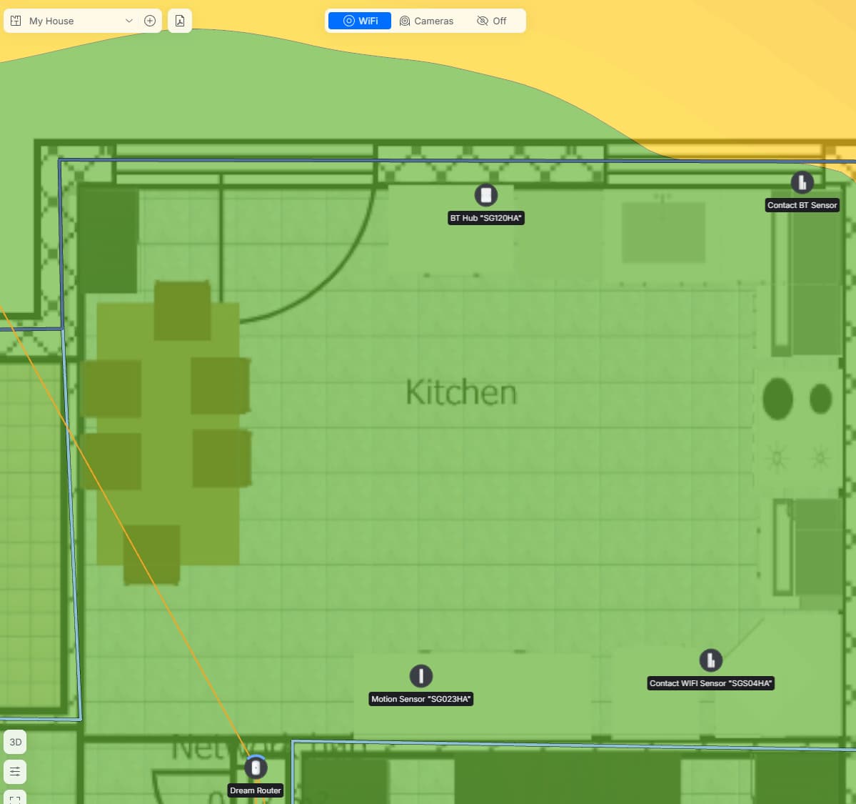

here’s my janky placement over my UniFi map of the kitchen ~20M SQ (5.2M x 3.8M)
Those distances should work ok.

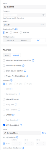

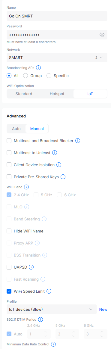

A little nag in the back of my head about UniFy needing some tweaks to work with IOT devices - maybe some searching will unearth it.
You are right. This is what I have set it to.
I have 32 devices on this network. It’s got its own VLAN for tuya, ESP, shelly and the sonoff stuff. The 3 devices that have always had issues are:

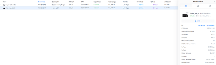

TUYA product have been generally good. except for this unit, i can see the NIC/device is online on the unifi platform. offline on SmartLife and HA

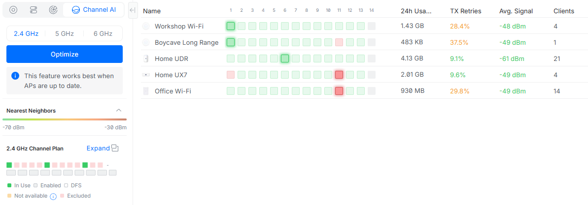

Curious on RSSI levels for your devices, both working, and unreliable. Are the signals borderline for some?
Static IP addresses all around?
Fixed channel WiFi? Any overlaps with neighbours that have foolishly fiddled with their router output power settings in the vain hope it will improve connectivity?

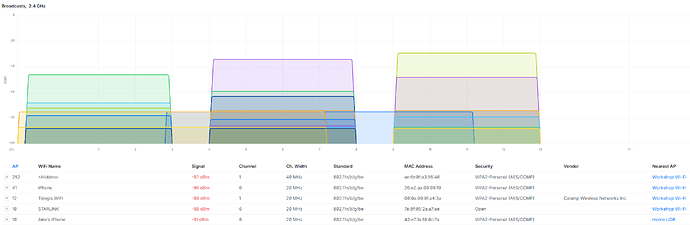

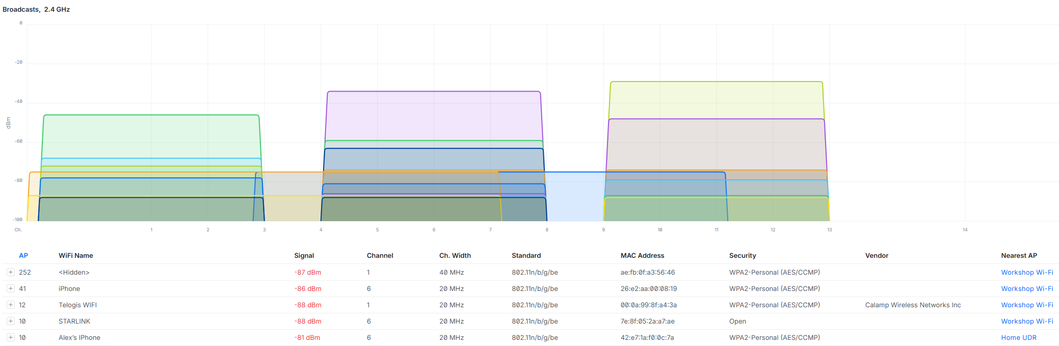

2.4GHz… 100% getting some cross talk with other devices. It’s less then >7% interference. It’s better than in most of the commercial deployments I do. Theres only a couple of selfish neighbours who have miss configured AP’s. here is a month of spectrum analysis.
Both devices are really close to the WAP’s (each one is in a different area of the house, so they connect to different ones. amazing signal’s -45dB and -67dB.

Is the hidden SSID double width channel one you control? Maybe it is splattering all the other ones. Try with 20Mhz spread and see if anything changes much.

I have an app on my Android phone called WiFi Analyser by FarProc (not on Google Play any more, but the latest version 3.11.2 is working well and downloadable from third party open source websites) which has graphical and audible feedback that is very handy to detect signal issues, directional preferences, channel optimisations, and hot and cold reception areas. You can watch the results of moving devices in real time, channel allocation for both 2.4Ghz and 5Ghz devices, etc. Free, and I would have paid good money for it in retrospect as it is a valuable tool. Highly recommended.

Q: Is the hidden SSID double width channel one you control? Maybe it is splattering all the other ones. Try with 20Mhz spread and see if anything changes much.
A: Those are all the external devices/APs fighting for 2.4GHz spectrum. They are causing ~7% cross-talk. minor issue, that cannot be solved.

A: The Unifi platform has an equivalent in the platform, also used WiFi Analyser, inSSIDer, Wifiman and Sidekick. Still not a network issue

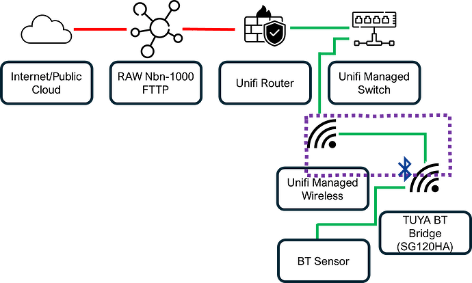

A: Want to get to that point. The issue is lower on the OSI stack; no point trying to triage end-user device issues.
I’ve highlighted in PURPLE this issue I have identified. Which is the same issue from the original post from someone else, the only common thing is the BT Bridge, which has an inconsistent network stability
