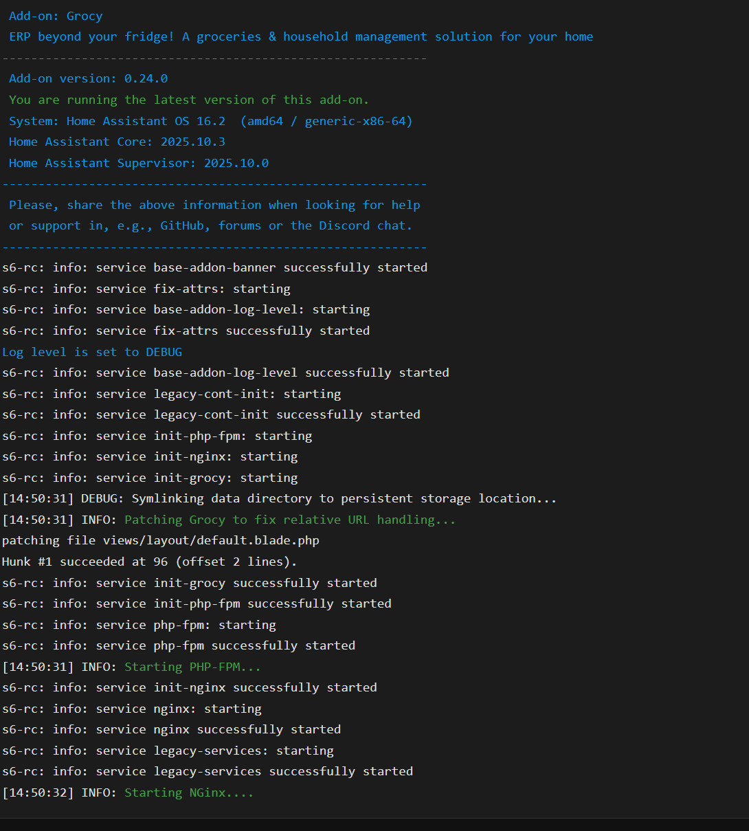

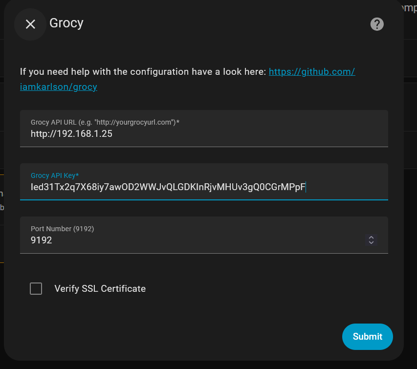

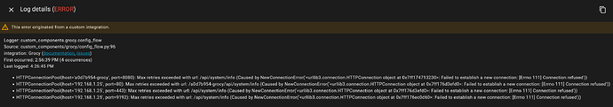

I’m hoping someone can save my sanity on this. I’ve been trying to get this connected and just get the “something went wrong” error.
Looking in the HASS Core logs I’m getting the error “Failed to establish a new connection: [Errno 111] Connection refused”. I’m not seeing any errors in the Grocy logs.
The API URLs I’ve tried are
  • http://[Grocy Hostname]
  • http://[local IP for HASS]
  • http://[local IP for HASS]:port for HASS
  • http://[local IP for HASS]/[Grocy Hostname]
I’ve tried generating multiple API keys and the ports I’ve tried setting are 9129, 80, 443, random ones I manually set in the config. At this point I’ve gone through every possible combination of those URL/Ports all with the exact same results.
while I couldnt find any issues with the port being already used, I changed it to 9195 and on my 2nd attempt I was able to connect. I have a strong feeling there is an issue with the integration itself as it constantly becomes unavailable once connected.
I also tried downgrading and upgrading but not sure if it had any effect.
Worked for me too.
