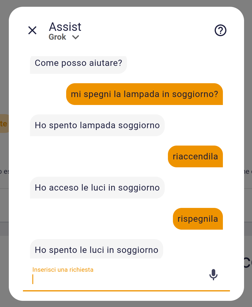

The core idea is to drastically reduce the number of tokens sent to the LLM by offering an alternative interaction method to Home Assistant’s standard one. Grok doesn’t process every single request; instead, it acts as a smart router. It analyzes the user’s input, corrects any ASR (Automatic Speech Recognition) errors, and then makes a decision:
  • If the request is a simple conversational question (e.g., “tell me a joke”), Grok responds directly.
  • If it’s a smart home command (e.g., “turn on the living room lights”), Grok extracts only the essential command and sends it to Home Assistant for native processing.
This logic is implemented through a Pipeline.
The Pipeline
  • LLM Analysis (Grok): The user’s input is analyzed. If the request is a command, Grok doesn’t process the entire context; it just extracts the relevant part. For example, from “Could you please turn on the living room lights?” it extracts the concise command “turn on the living room lights.”
  • Command Tagging: The extracted command is then encapsulated in a special tag [[HA_LOCAL: {"text": "natural language command"}]]. This tag signals to the system that the request should be handled locally. This crucial step has allowed me to send far fewer tokens compared to a traditional integration, with a significant impact on cost and speed.
  • Native HA Processing: Home Assistant receives the concise command via the tag and handles it using the local conversation.home_assistant service. If for some reason the recognition fails, there’s a fallback option that allows for a second call using Home Assistant’s standard tools. This provides an additional chance for the command to be executed, increasing overall reliability. If you add Home Assistant’s native intent handling step (first locally, then to the LLM), the process becomes even more efficient.
In summary: This integration allows for a more fluid and natural conversation with an LLM, without needing to articulate words precisely to activate an intent.

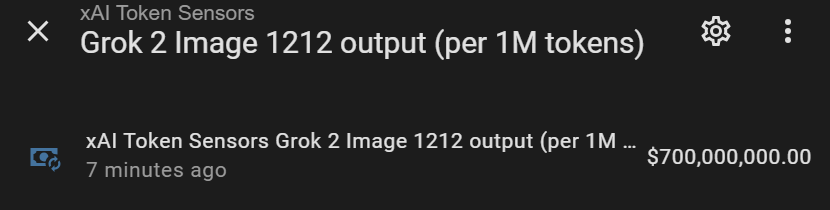

edit: i don’t know how i plan to leverage this yet, but i am excited for xai_conversation.reload_pricing and xai_conversation.reset_token_stats
the new default of grok-2-vision-1212 may be out of my price range…
Thanks for the feedback, I’ll look into the token pricing issue that I thought I’d finally solved, but apparently not.
