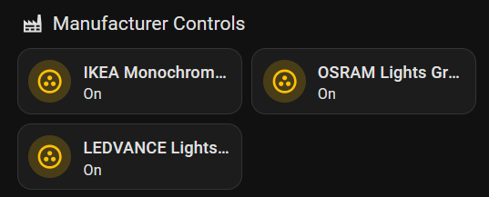

Hello, I have a mix of several brands of lights in my setup with various controls (Brightness, White Balance, Color mixture)
While creating a group of all lights so I can turn everything off at once using toggle buttons, I noticed that the white balance (light temperature) control for my bulbs is not aligned, since the group has 2.5 different manufacturers (OSRAM / LEDVANCE, IKEA) HA does not know that 3200K of IKEA TRADFRI isn’t the same temperature of 3200K of OSRAM Smart+.
This is why I asked Gemini to create a blueprint for me for grouping lights by manufacturer, so that I can control the white temperature throughout the house and balance it between the manufacturers.
