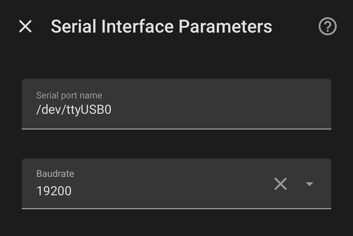

Thanks for the reply , i currently have a RS485 to USB cable but i couldnt get it to work inside HA.

4
The Solax integration should support serial over usb too
(but haven’t tried it, as i don’t have a usb port available).
