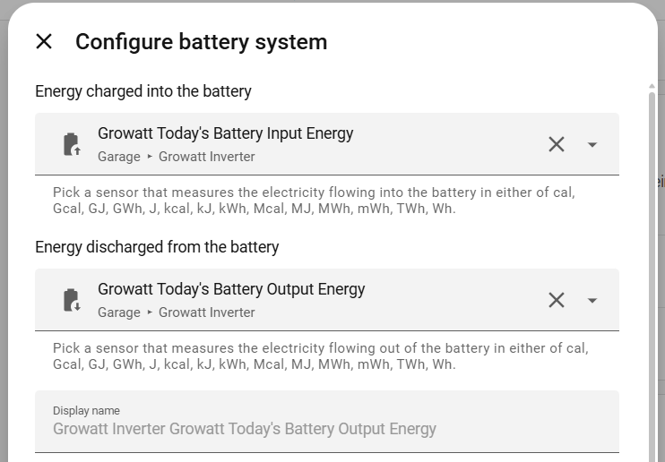

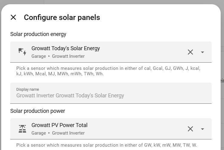

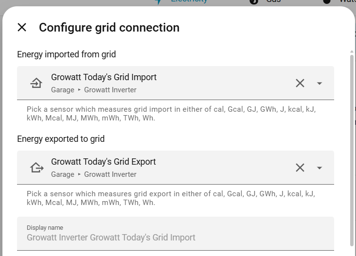

What part of all the entities do I need to setup the Home Assistant energy dashboard to show the daily production for my solar panels (two separate string).
How do I find the correct one?
I use these
