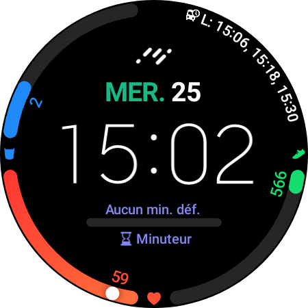

As to how I use the data: I simply use a template to split the data into several sensors per stop I need (stop_arrival, stop arrival1, …) so that I can show them easily in lovelace.
I also show the departures on my watch, and it changes depending on my location (if I’m at home, it shows Stop1 departures, if I’m in town stop2, etc)
To do that I am using a template that changes the data shown depending on my location.
Top right corner :
Screenshot_20231025_150208_sysui
