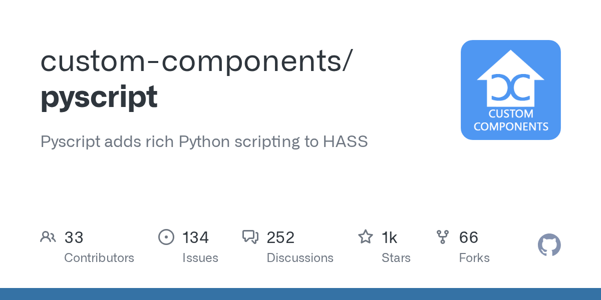

I am very happy with pyscript custom integration.

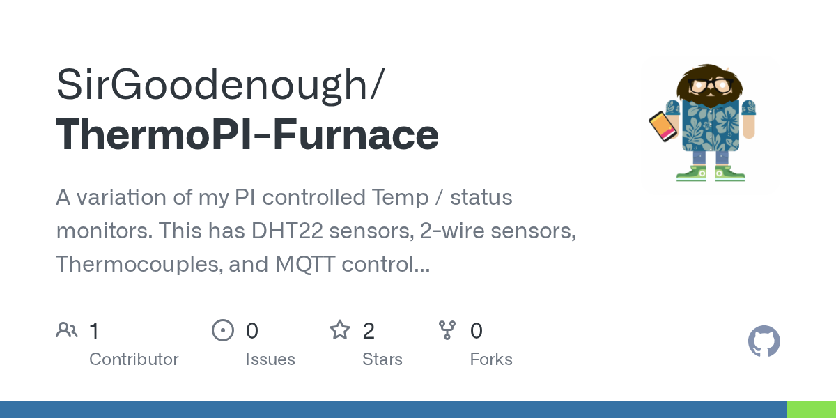

I’ve hacked together a couple of python scripts that act as sensors. I use
MQTT to transmit the data…
