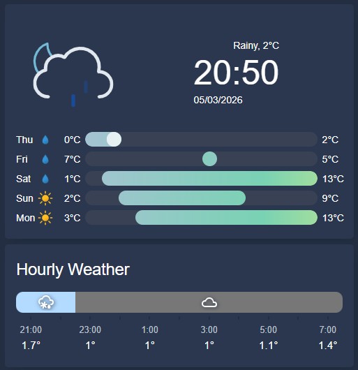

I am looking to make a custom card to show weather. I want it to be a combination of clock weather card and hourly weather card. I am trying to build a card that has:
  • the top portion of clock weather card showing the picture/time
  • a middle portion showing the hourly breakdown for the day
  • a bottom portion showing the 5-day forecast
My planned approach is going to be:
  • make a vertical stack that has 3 cards
    • first card is a clock weather card (where I would modify to turn off the forecast)
    • second card is the hourly weather card
    • third card is a 2nd clock weather card (modified to only show 5-day forecast)
    • Use Card Mod (or UIX) YAML adjustments to tweak for visual display and consistency
