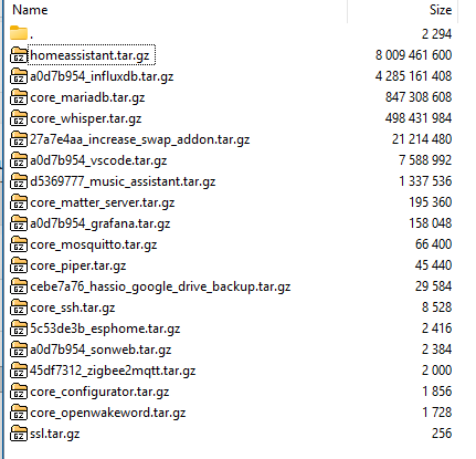

After a moment of panic, I realised my local backups and backups to GoogleDrive were still working, and it was only the Nabu Casa backups that were failing, and this was because my backups had jumped from 4.6Gb to 12Gb, which obviously exceeds my Nabu Casa storage.
I have no idea what could have caused this increase in size, so I downloaded the last backup, looked at the contents in 7-Zip.
Clearly I could remove my influxdb database (It would be uncomfortable losing the history, but in an emergency I could get my house back up and running)
but 8Gb “homeassistant.tar.gz” is still more space than I have on Nabu Casa storage, and I have been unable to open that to find what it contains.

Unzip the 8g tarball and see what’s inside. That’s the HA backup it’s just an compressed folder (possibly encrypted.)crack it open.
It could be any of media files, (orphaned camera snapshots was mine - 3 years of Doorbell cams.)temp files, your database… (id bet this… If someone has timescale setup like influx you’re probably keeping EVERYTHING) you could backup influx separately off box.and make sure it’s not in this backup.
You’re the only one who can tell.
And 8g? Mines 15…turned off Nabu backups a long time ago…
