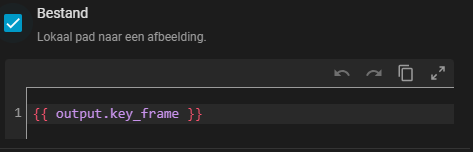

For example, the notification to my Telegram bot uses the direct key_frame

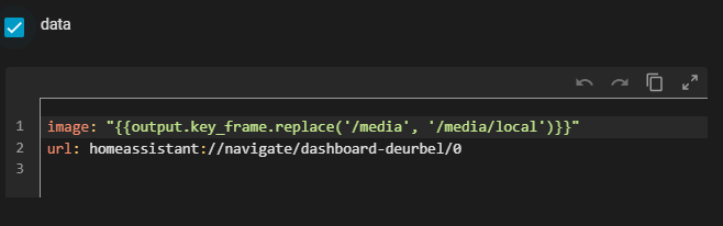

Where the direct HA notification to the phone of my wife uses an extra .replace to load the image file.

      - alias: Stuur via Telegram naar George
        action: telegram_bot.send_photo
          authentication: digest
          config_entry_id: *Telegram bot*
          caption: "{{ output['response_text'] }}"
          file: "{{ output.key_frame }}"
      - action: *notify.mobile_app_*
        metadata: {}
          message: "{{ output['response_text'] }}"
            image: "{{output.key_frame.replace('/media', '/media/local')}}"
            url: homeassistant://navigate/dashboard-deurbel/0
