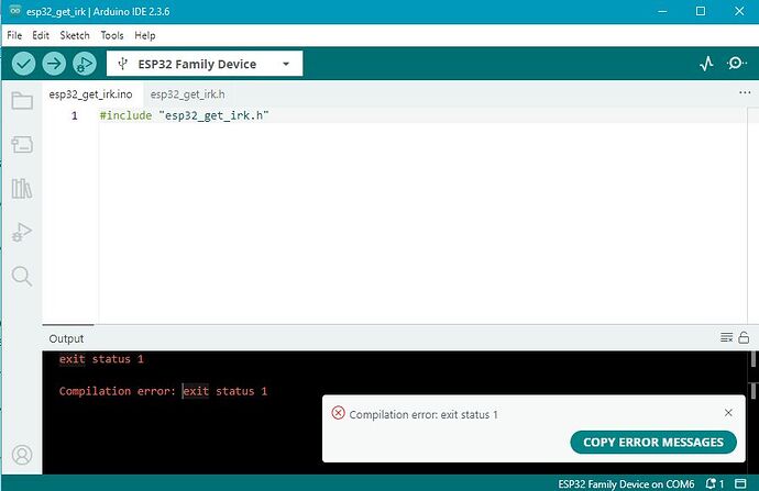

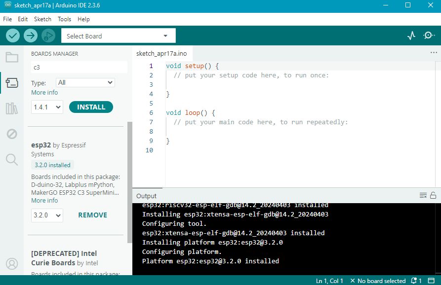

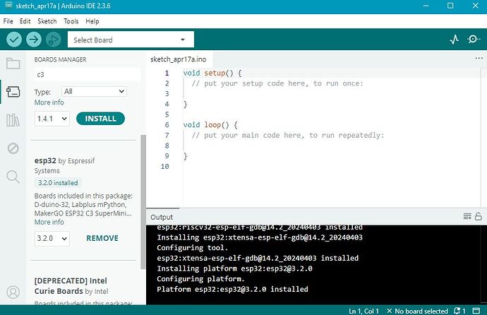

I have an ESP32-C3 Super Mini.

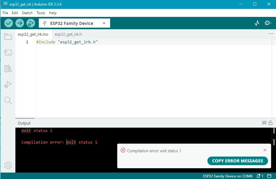

I installed Arduino IDE, ESP32 Espressif (which states the C3 Super Mini is included) uploaded the .ino and seem to have fallen at the first hurdle.
COM Port definitely OK.
FQBN: esp32:esp32:esp32_family
Using board ‘esp32_family’ from platform in folder: C:\Users\Smurfs\AppData\Local\Arduino15\packages\esp32\hardware\esp32\3.2.0
Using core ‘arduino’ from platform in folder: C:\Users\Smurfs\AppData\Local\Arduino15\packages\esp32\hardware\esp32\3.2.0
cmd /c if exist “C:\Users\Smurfs\Desktop\DecodingRandom BT\esp32_get_irk\Arduino\esp32_get_irk\partitions.csv” COPY /y “C:\Users\Smurfs\Desktop\DecodingRandom BT\esp32_get_irk\Arduino\esp32_get_irk\partitions.csv” “C:\Users\Smurfs\AppData\Local\arduino\sketches\9F32F74414D868D212F10864F7DEA69D\partitions.csv”
cmd /c if not exist “C:\Users\Smurfs\AppData\Local\arduino\sketches\9F32F74414D868D212F10864F7DEA69D\partitions.csv” if exist “\partitions.csv” COPY “\partitions.csv” “C:\Users\Smurfs\AppData\Local\arduino\sketches\9F32F74414D868D212F10864F7DEA69D\partitions.csv”
cmd /c if not exist “C:\Users\Smurfs\AppData\Local\arduino\sketches\9F32F74414D868D212F10864F7DEA69D\partitions.csv” COPY “C:\Users\Smurfs\AppData\Local\Arduino15\packages\esp32\hardware\esp32\3.2.0\tools\partitions\{build.partitions}.csv” “C:\Users\Smurfs\AppData\Local\arduino\sketches\9F32F74414D868D212F10864F7DEA69D\partitions.csv”
The system cannot find the file specified.
exit status 1
Compilation error: exit status 1
What can I do to help anyone who knows what it is really telling us, to debug this please? I have put a note on Github btw.
[EDIT] I verified that a plain vanilla ESP32-WROOM compiles fine in my IDE install (I even got IRKs for my Apple Watch and iPad) so it must be down to the .ino not being compatible for the ESP32-C3 (despite the Arduino ESP32 Install for Espressif ESP32 including that variant).
OK, replying to my own query, the fryefryefrye fellow came back on Github, apparently you have to use an OLDER version of Arduino for the ESP32C3 (note that the newer version of Arduino, v2.3.6 actually worked OK on my ESP32-WROOM).

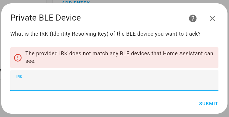

Just now I used the Windows tutorial on Private BLE Device - Home Assistant to obtain the IRK’s for both my phone (S20 FE 5G) as well as my Nothing Watch Pro 2.
When trying to add them, the Private BLE integration says it’s not picking up devices that match the entered IRK’s.
That could be right, since I don’t see my phone, nor my smartwatch in the long list of devices in Bermuda. Both have bluetooth enabled (and currently connected to each other), both support BLE… not sure what I’m doing wrong. Did I miss something?
Should maybe note I did not see anything named “irk”, just a valuename using the MAC-address of the device as name and a hex-string that looks like an IRK as value.
edit: I used the ESP32-method, got a different value this time from my phone that is actually accepted, not sure how to use this method with my smartwatch.
